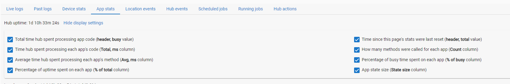

If you go to logs, and go to app stats, and click on all available columns, that should help you narrow your search:
