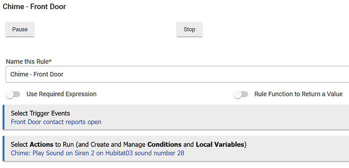

For me personally, i'm just using chime as a description of what i'm attempting to do. The chime function exists as something you can "call". In this case, i called an AI sound i made that just says "Front Door" when the front door opens.
The ZSE50 is can act as a speaker or a siren, which hubitat seems to treat differently. This new driver was what added the ability to use it as a siren, when means you can tell HSM to sound the "siren" command when an event occurs, which it seems that is configured by setting the sound file number in the configuration of the device itself. Then when i want the chime to function, i tell it to play whatever sound number corresponds to the event.

When i utilize that rule as I posted there from rule machine, and i have the Siren configuration said to loop, running the chime command and calling sound 28 causes it to play on repeat until a stop is initiated. Now, if i tell it to only play the siren once, the chime only plays once BUT then it also causes the siren to only play once. So, the way that it works currently, if you want a consistent siren but you also want to be able to play a sound for other occassions, you cannot do it without creating further logic or like jtp said, flip the configuration every time one of those actions is performed.
So what you're saying is if the 'Siren Playback Mode' is set to loop it affects all the other sounds? Yeah, I can see where that is a problem. I never changed that setting so thus never saw the issue.
If I am correct on this that setting really should be called something else. To me it would infer it only applies to siren, but what do I know.
Bingo. You got it! and I agree, it's misleading.
Its only misleading due to the way I assume the driver was built (I have not actually seen the built in driver yet).
Those settings for the device apply to all sounds played AFAIK. There is no different way to initiate a "chime" vs a "siren" to the device itself, the driver would send the same command for both. You can either specify the tone number to play or send 255 to tell it to just play its default. This is per zwave specs of the class the device uses.

For now I would try doing as someone suggested as above, set the settings for how you want the "siren" to work. If you want to do a single chime then send a delayed off command to make it stop when you desire.

Not really sure what you are referring to? You can customize it with the settings, yes, but that applies to all tones played. If you want one tone to loop forever and another to only play once then those settings do not allow that. You would have to change the settings between each playback.
