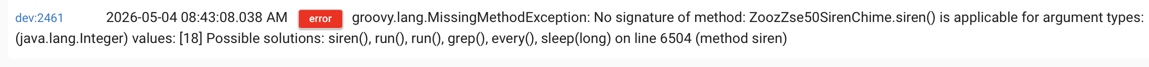

The “siren” command doesn’t have any parameters. You need to change it in preferences page.
Play sound DOES take a sound parameter.
Neither does strobe.

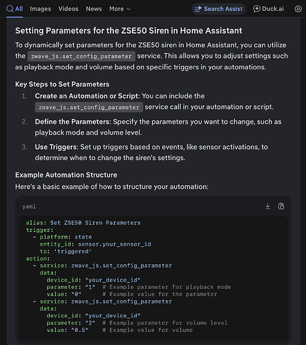

Perhaps I'm missing something and there's (another) driver wizard in web land who's written something. Or it may be time to look into Home Assistant. I wonder if the integration with Hubitat is local? Network? There's always an AI robot. Argh.
