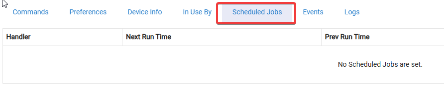

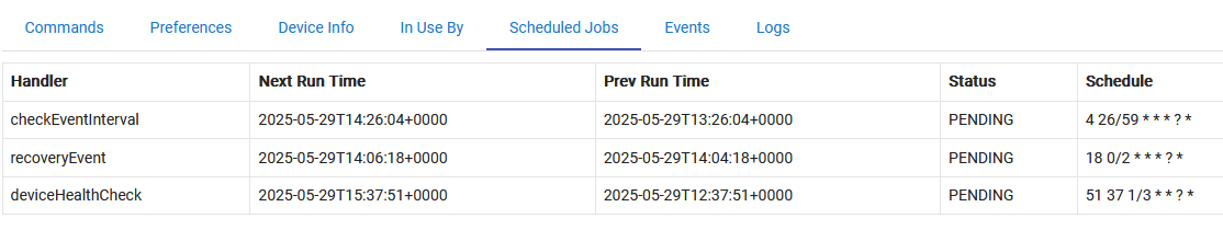

Sounds like you might have a scheduled job left over from another driver?
You can check the Scheduled Jobs tabs on the device page to confirm.
Then you can go to the main Logs page (on left side bar), then Scheduled Jobs.
Find that job in the lists and delete it.

If the apps are creating those scheduled jobs then they would only work with drivers specially designed to work with them. Those are not standard functions that system drivers or any custom drivers are expected to have. I am not even sure if apps can create scheduled jobs on devices. I still suspect those jobs were created by a different driver, not an app.
Do other devices you are using in those apps have these same scheduled jobs?
My driver does not have any of those functions so all those scheduled jobs will throw errors. If you want the errors to stop you need to remove them as I detailed above.

I have 5 ZSE18 devices, and I cannot reproduce the error you have posted. The error must be related to something else on the system. The device driver itself does not seem to create any scheduled tasks if it's own, therefore it is not responsible for the scheduled task or the error that is being caused.
There are 2 possible issues:
  1. you have tried multiple device drivers for this device without clearing out the previous drivers scheduled jobs between driver changes, and those jobs are still running but this driver didn't create them or understand what to do with them.
  2. one of the apps you are using to monitor the device is trying to perform an action on the device that it isn't designed to deal with.

No. What is happening is that you used a different driver the past and need to perform one of the solutions above if you want the error to stop appearing. If you know the exact driver you use when this began (the only ones I can think of with a job name like this are Zigbee, which you shouldn't use with these, but any developer can choose any name, so there are no constraints on what this could have been), switching back to it can help, but if the built-in driver meets your needs, I'd suggest the above instead. It will also be much easier since you won't have to remember or guess (or use the wrong driver if you did the past).
Note that the driver linked to in the post just above mine does not use this scheduled job and so will not address the issue, either. You will need to do what has been offered as the solution above with either this or the built-in driver.

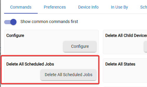

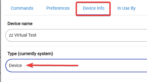

If you cannot find the scheduled jobs using the above method, the other way to remove the scheduled jobs is to change the Type/Driver to "Device" and then run the command to remove all scheduled jobs. Then switch back to the system ZSE18 driver if thats what you want to use.
Run the command
Scheduled Jobs should now be blank
Okay, steps I took just now: I changed the device drive to Device, reset everything (variables, status, children), and then reinstalled the @jtp10181 drive. Now I don't see any errors. Below is the log.
