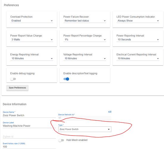

What I do see that you will want to change for sure is you want only 1 or maybe 2 power reports. You have all 6 turned on, and on very low settings, so you are possibly swamping your network with power reports. I would suggest Power Report Value Change, and possibly Power Reporting Interval and shut the rest off. Even then, set these as high as possible and still get good readings.
Changed all reports except power reports to 10 minutes because that is all I really need to trigger my rule . Did hit configure. Still only refreshing when I do it manually. Frustrating!
What Device Handler are you using? Mine is 'Zooz Power Switch'. I am hoping this is the problem but do not have my hopes too high right now.
Yep, Zooz power switch driver.

The device is sending power data like crazy - probably 10-20 times per minute. I want to configure it so it just sends power data every 30 seconds. Just to keep the network clean. I have set the parameters below but nomatter how I set it, the wattage just keeps coming in every few seconds. Anyone with any idea how to keep that from happening? I did press the configure button after changing parameters but that is all.
@tony.fleisher @neonturbo Pinging you guys to see if you can answer my above question. You were both great in identifying having to turn off security to get the power data to send but now the hub is getting pinged like crazy. I set the power reporting interval to 30 seconds but it does not seem to look at that. Any ideas?
I set the percentage change and value change to really high numbers instead of "no reports" and it cut back the traffic quite a bit
