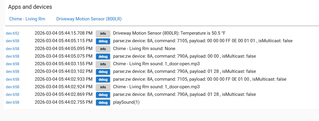

I have attached another screen capture with debug enabled. This is what was logged when playing a sound from the Device Details Commands screen.

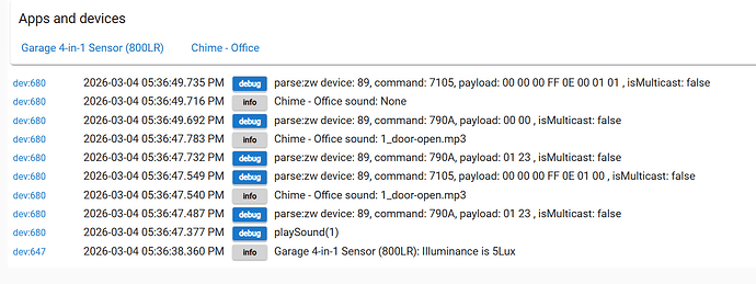

The following is a screen shot of another Chime Device

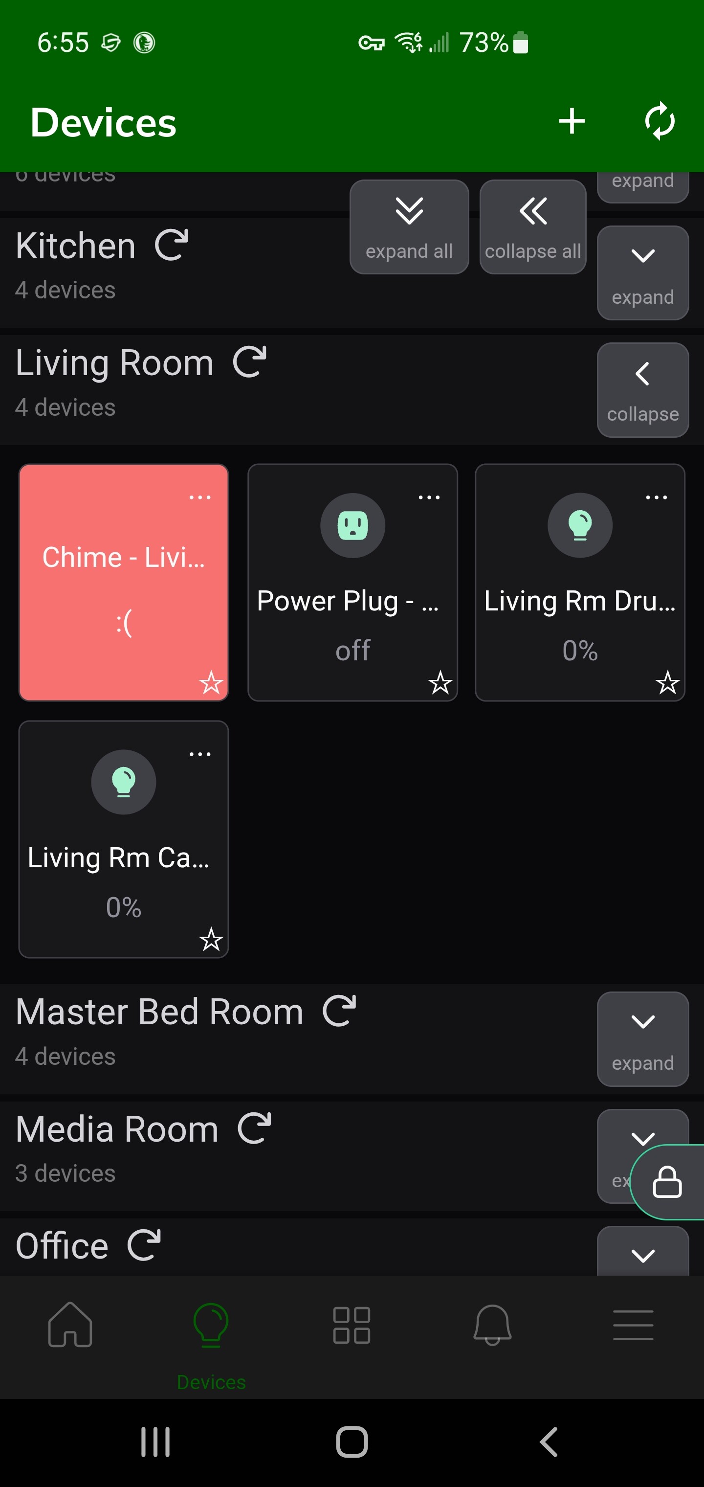

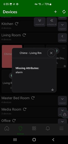

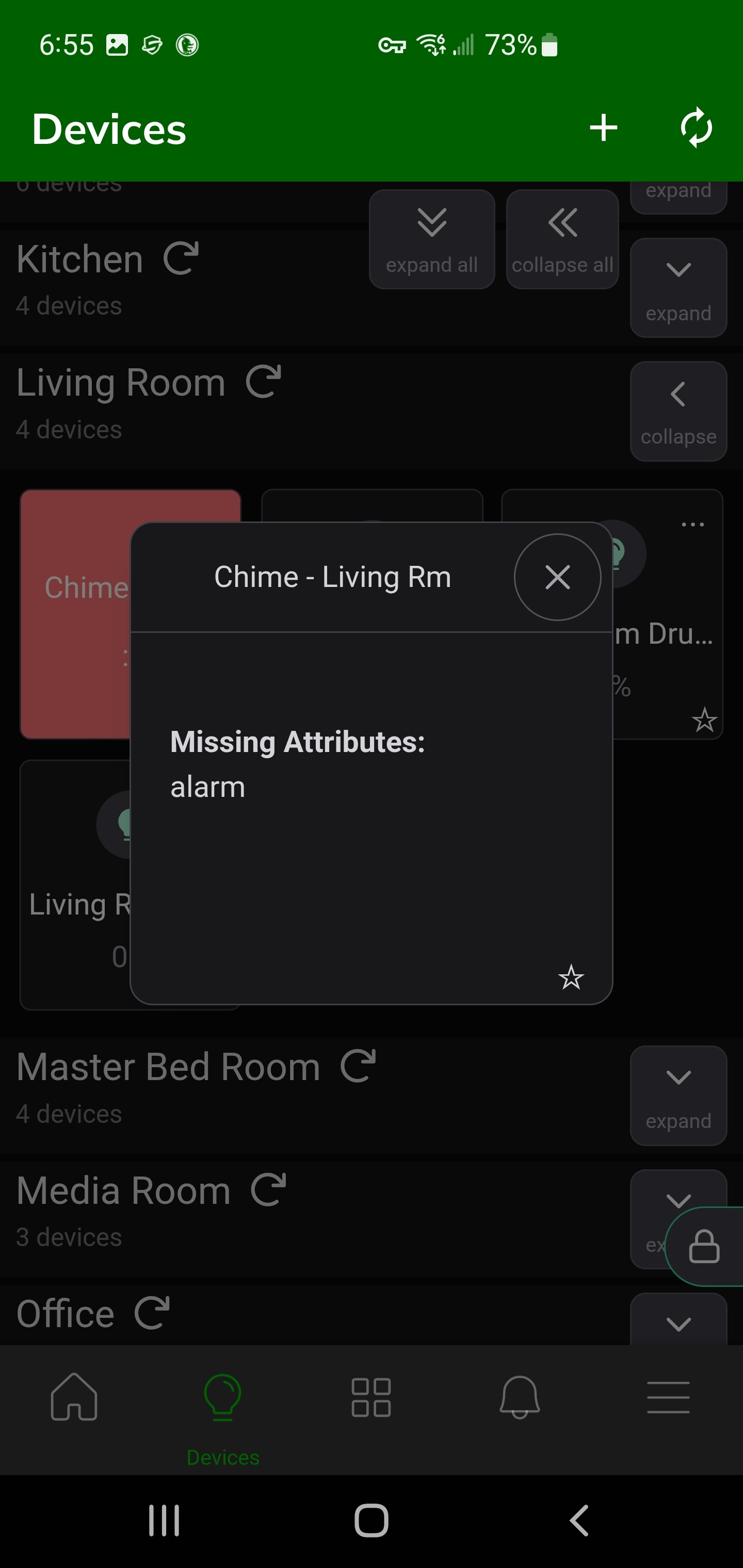

I have also attached a couple of screen shots of the Hubitat Phone Application. I noticed that all the Chime devices show up in pink with a sad emoji. The details indicate missing attributes, but in the Hubitat Hub the everything looks fine. I tried "Configure" and "Refresh" on the Hub Device page but that did not change the status in the Phone App.

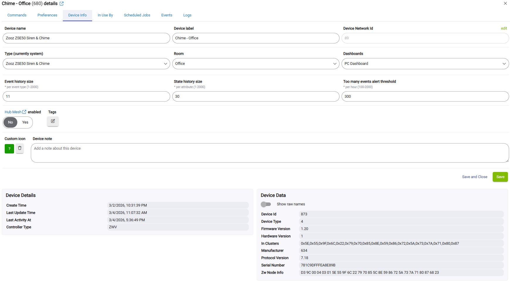

The following is a screenshot of the Chime Info screen in my office
Based on that debug log, you are on Zipgateway..
It also seems that, at least the driver level, it's not sending the command more than once.. There is no code on the hub side that will re-transmit a command. the only place that could happen is in Zipgateway (or ZWave-JS), but that is normal re-transmit when no ack is received..
