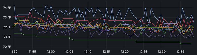

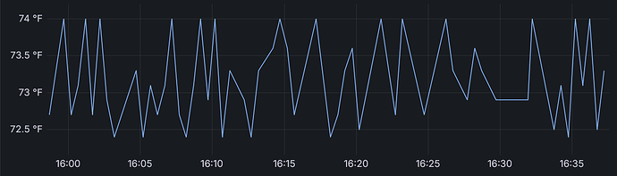

I got a bunch of ZSE44 sensors and when trying to calibrate them found that they have 1-1.5 degree F jitter. The image is a sample of one of them. This is in a room with a steady temp. After several days of back and forth with support the only solution they could provide is that I should set the sensor to only report on 2 degree changes.

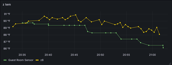

This is a different time period and the green line is a Third Reality sensor correctly reporting the room getting cooler. The other lines are all ZSE44's with the latest firmware.

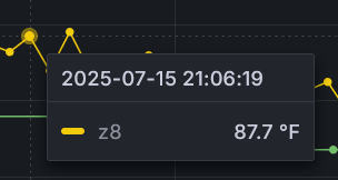

They finally gave me a return label saying the sensors apparently don't meet my use case and it warns there will be a 30% restocking fee.
Best I can tell there is actually a bug in the firmware since the zwave radio logs show the devices re-broadcasting messages several times with ~4min delays.
It looks like the Third Reality just reports less often, with fewer data points. What is the difference in the number of data points on that graph between 3rd Reality and ZSE44s?
I don't think you can claim that. What is keeping it "steady"? How do you know that the temperature around the sensor is not actually fluctuating? Rooms temps are not consistent in all areas of the room, and any movement will move air around. Any heating or cooling will cycle on and off and will show in the temp readings, often showing 1-1.5 degree changes, at least.
If a sensor does not report as often, you will not see the spikes, you see only the general drop.
I have an inverter heat pump that keeps the temp within 1 degree most times. The Third Reality sensor reports on 0.2F change. I also have a NIST traceable thermometer I used to check it. On top of that I have a weather station thermometer in the same room, and I did leave them in a cooler overnight to buffer against any changes overnight but they did the same thing.
I can tell you for a fact that the room temp does not go from 72.4, to exactly 74, back down to 72.4 then back up to exactly 74 several times every 5 minutes. I do still have one ZSE44 that is not boxed up so I'll warm it and the other one up and put them back in the room to get that data graphed.

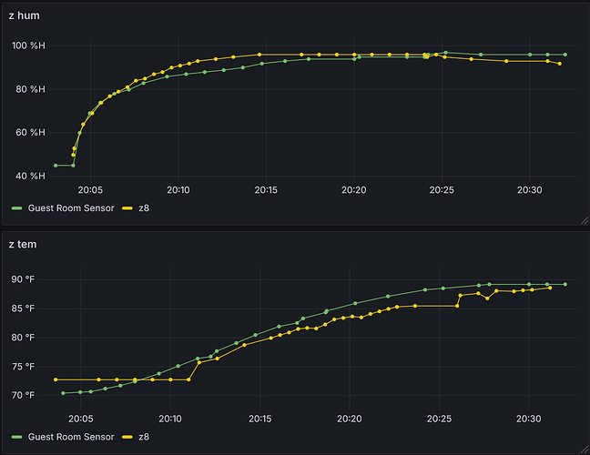

This is after putting both sensors in a cooler and adding a measuring cup half full of hot water. Each dot is a report from the sensor and the ZSE44 is the yellow one.
And this is after it leveled off and the cooler started to cool off inside. AKA, should not be any increases in temp at all since the cooler is in a 70 degree room.

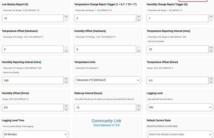

What driver are you using?

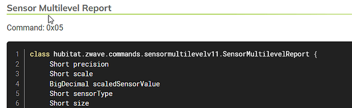

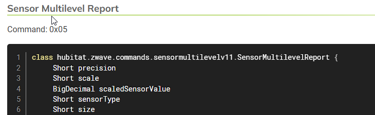

https://raw.githubusercontent.com/jtp10181/Hubitat/main/Drivers/zooz/zooz-zse44-temp-humidity.groovy

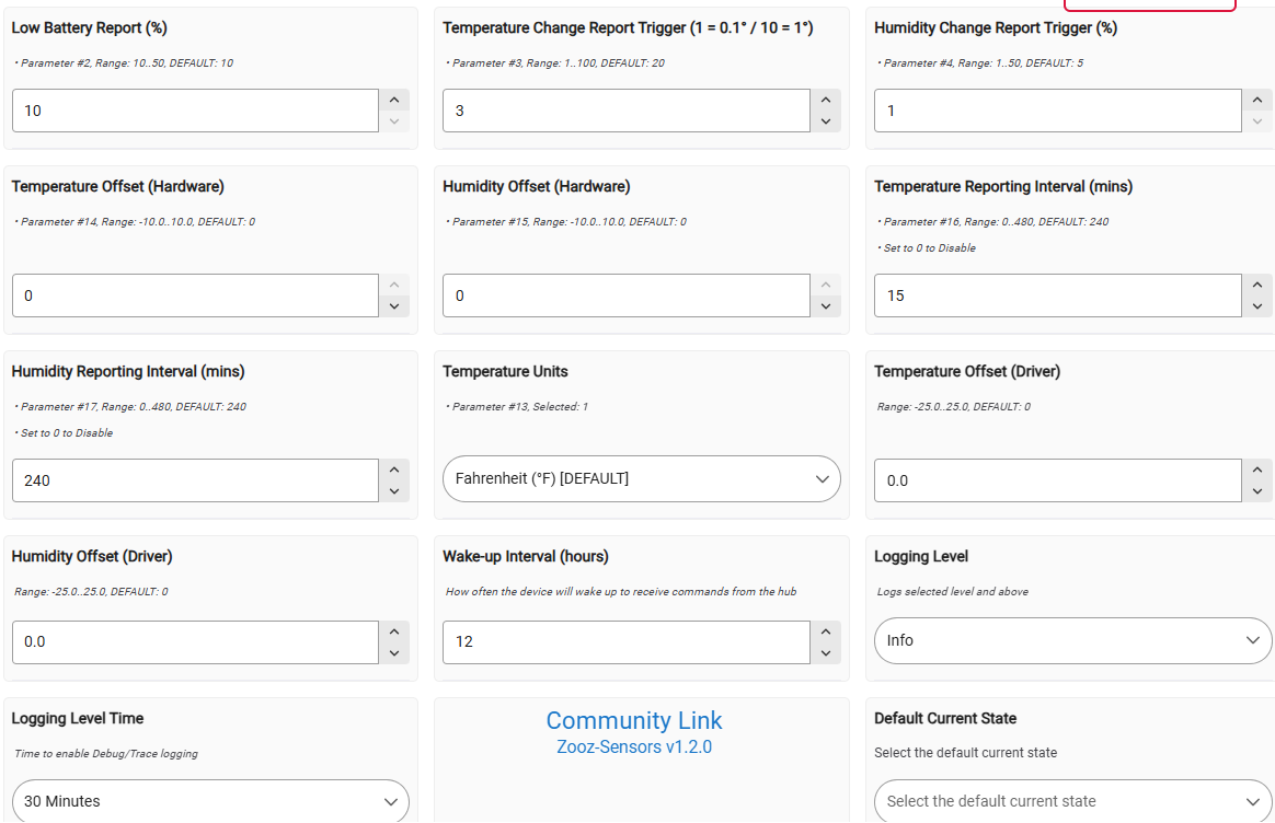

With line 180 modified to allow .1 degree reporting so I could better calibrate it which is supported since I have 800 series sensors.
https://www.support.getzooz.com/kb/article/853-zse44-temperature-humidity-xs-sensor-advanced-settings/

+-1.5 degrees? In my case, it would jump to 500 even 1000 degrees... but for very short periods of time. I like ZooZ products overall and I have many, but I'll never get another ZSE44 again.
If you look at the first image in the post. That one sensor was jumping between less than 72.5 and back to exactly 74 with as little as a min between them at times. I think the lower values were the correct ones and everything above just old readings getting resent on a loop.
@jtp10181 Does your driver have access to a message number or serial? Something that should be unique per temp report that could allow the driver to discard repeated messages.
The device spamming old messages would still nuke the battery, but discarding repeats should make them usable at least.
Well that eliminates ZWJS as the issue then, it could just be the sensor. I only have one on Hubitat old one and its set to 2 deg threshold and in my garage. My chart looks pretty stable.
I do have a new model paired to SmartThings (test device) but the chart is not great on there. I can see the history though, looks pretty stable. The sensor is just sitting on my desk with the cover off. Its set to a threshold of 1 deg.
This is the command class the reports come in as, looks like Hubitat is not passing a sequence or anything like that over to the driver.
I would be curious to see what all your temp related settings are set to?
Right now I have it set to 3 to see if there is a point that it stabilizes or if you just need to increase past the reading fluctuations.
The I2c sensor specs say +/- 0.2 C, so I started to wonder if the sensor has jitter in its reported value and setting the device too low is causing interrupts resulting in the device not knowing messages were received causing a cache and resend loop.
The ZSE44 advanced settings for the 800 version does say it can be set to 0.1, but maybe they did not fully test that and the device firmware can't handle it.
I say this since setting to report on 0.2 still fluctuated a lot, but since setting it to report on 0.3 it seems stable. The device warmed up when I touched it to wake it, but it is now reporting the cooldown in 0.3+ increments without spikes to old readings.
Oh yeah, I would not really go below 0.5 myself on any temp sensor.
Also the interval of 15 mins, that is forcing a reading at that interval. With such a low threshold you could probably set the interval a little higher and not notice any difference. Unless it is mission critical to get a reading at least every 15 minutes for some reason.
