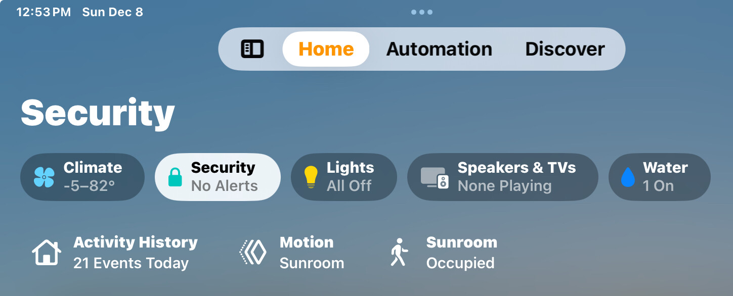

Motion sensors show a bit differently in Home App.

Hmm, never mind. I don’t share my sensors with HomeKit, the above is via my Ecobee thermostat.
Yeah I see both my multi sensors and my ZSE18 in that view. For a multi sensor it shows up as "4 sensors" and you have to open it up to see each individual sensor info.
Also keep in mind that in HK if your device name starts with the room it is in they cut the room off when showing the name in the tiles (which IMO is awesome). So if you have something named "Bathroom Motion Sensor" in the "Bathroom" it will just be listed as "Motion Sensor". Overall the way they handle sensors is a little confusing at first but makes sense and is great once you start using it more.
