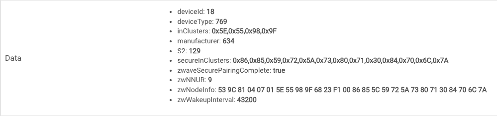

First, just to make sure the hub sees it as a repeater, open its device detail page (navigate to Devices and select your ZSE18 from the list, and look). Scroll down towards the bottom and look at the Device Details table. In the Data row, you should have a bullet point for inClusters. What ones do you see there? Specifically, look for the absence of 0x80 (or the absence of 80 in zwNodeInfo if you don't see anything else). This is the Z-Wave Battery command class, which would normally mean it's not paired as a repeater. (I have not checked this specific device, but it's how most like this work.)

Thanks for the outstanding explanation!!! So I think you've pointed me in the direction of why they're not repeating... They ALL have the 0x80 in 'secureInClusters' and 80 in 'zwNodeInfo'. I also am seeing the "Current State" set to 'powerSource: battery'. From the moment they were unboxed, the batteries were taken out and they were all excluded and then paired following Zooz's instructions on how to pair them as repeaters. What's really interesting to me is I know for a fact they previously did not show as 'powerSource: battery'. I forget the exact verbiage, but it did indicate wired power. This morning, all of them are showing battery.
Is there something that would trigger them to get changed back to battery? I'm absolutely confident they WERE all being recognized as usb power. I can go back and re-pair them all AGAIN, but I hate to go to that effort if they're just going to switch back on me again... without knowing WHY they changed. Thanks again so much for your help on this!!

By "following Zooz's instructions," do you mean that they were paired powered via USB with no battery? If so, that is odd, as I believe that it supposed to be the method that pairs them as repeaters. (The fact that this shows up in "Data" is highly suggestive of the fact that it always thought it was battery, as I don't think the "clusters" [command classes] or "zwNodInfo" data will/can change after inclusion.)
Zooz might have some ideas about that now that you know what the issue is, or it seems the poster above was able to pair it as a repeater and might have some tips. The only difference I can see is that yours was paired with security (S2 Unauthenticated) and his was not.
