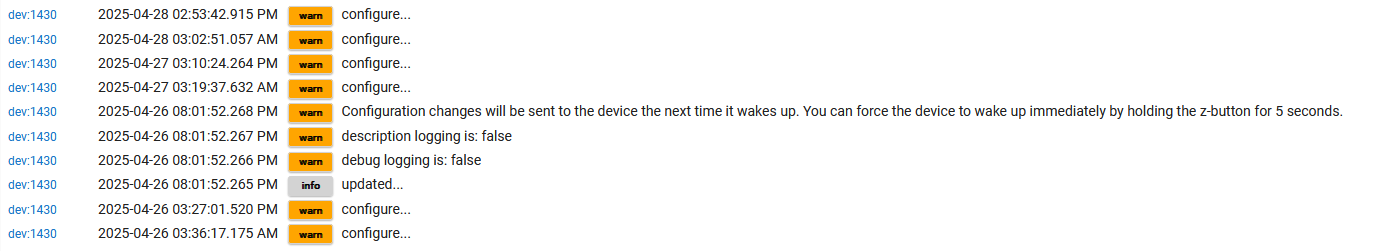

I get a warn configure... every 12 hours in my logs for both ZSE18 that I have. I have disabled all logging. I have also enabled all logging it does not make a difference. None of my other devices do this.

I don't see any problems here, but there is an oddity with this driver that it both logs "configure..." every time the "Configure" command is run and runs this on every wakeup in case you changed anything. So, this log entries just corresponds to the device's default 12-hour wakeup interval (and demonstrates that these devices aren't exactly atomic clocks :smile:).

Got the next build but am still getting this once a day on all 3. Is there a way to fix it other than using the other drivers?
That is a side effect of using my driver then switching to something else. I have it fixed in my newer code but it has not made it to that one yet.
You can fix it by either going to Logs > Scheduled jobs, find those jobs and delete them. Or you can switch any effected devices to the "Device" driver, use the command to delete the scheduled jobs, then switch back to the driver you want to use.
