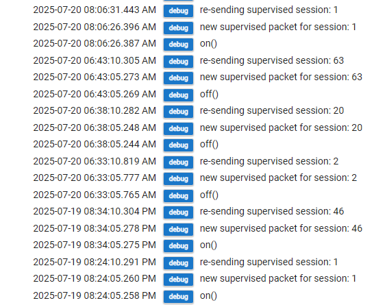

When they "freeze" up, the logs look like this:
And yes, I have read the "Read First" post and non of those have helped.

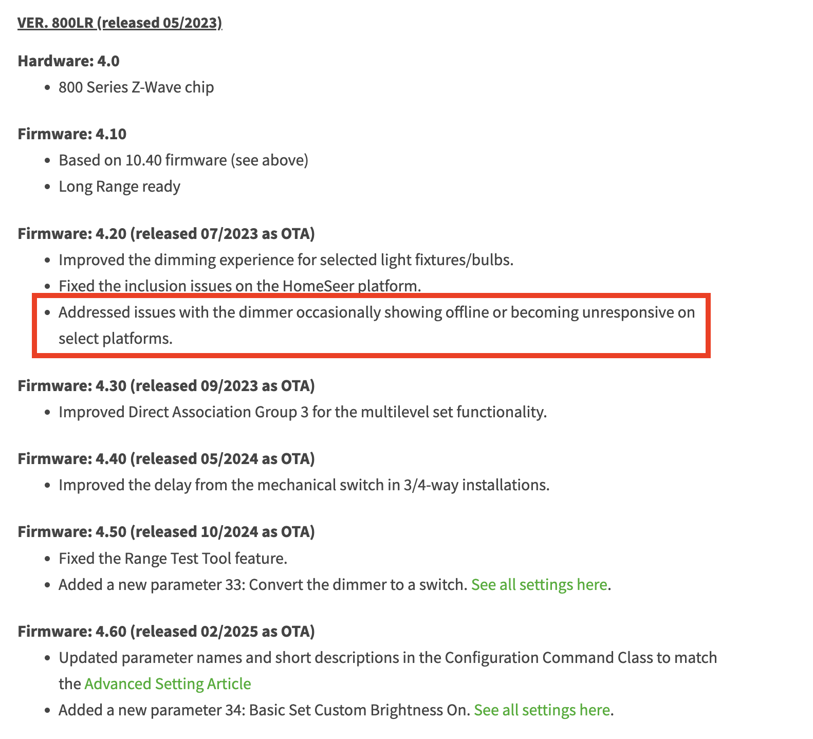

Since you currently have f/w 4.10, it sounds like you have the latest hardware model of the Z77...
Before doing anything else too crazy, I'd try updating the firmware for each -- the note I circled below sounds like it may be a winner... In my experience with Zooz stuff so far, Hubitat is very commonly one of the "select platforms" in these firmware notes :sweat_smile:

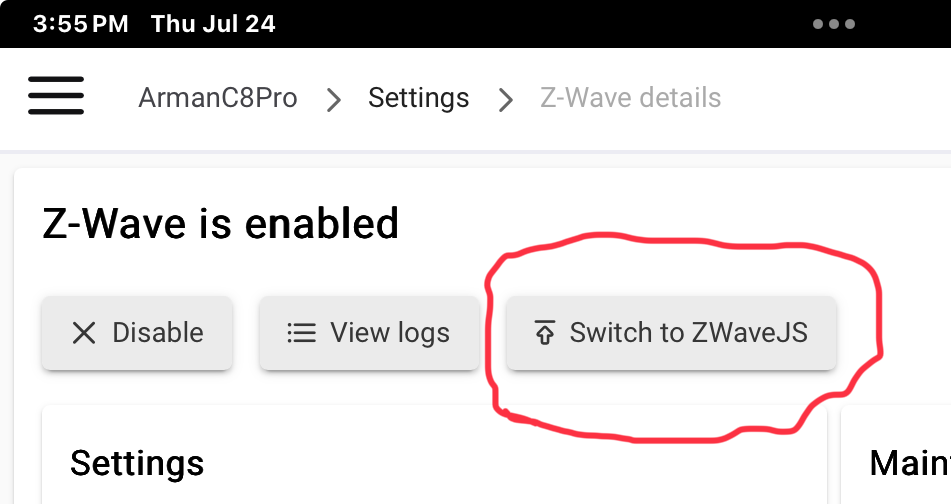

Look in Zwave Details. If yours looks like this then you do NOT have ZWaveJS installed,.
If you don’t have a C8pro, then you won’t see any message there. And also no ZWaveJS.
This hub is a non pro C8, so I guess no ZWaveJS
