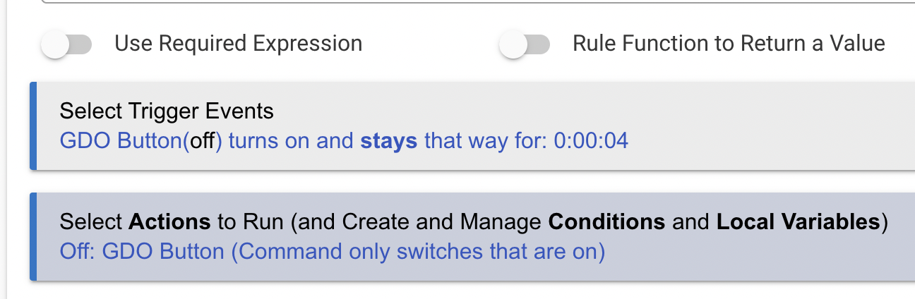

I forgot to include this ealier -- AFAIK, this fail-safe rule has never come into play, but having it helps me sleep better at night...
"GDO Button" is the relay on my Zen17 that (via parameters) has an auto-shutoff time of 2 seconds.
