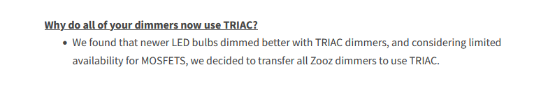

This is potentially normal with any dimmer when using with LED lights, especially cheaper LED bulbs. Looks up TRIAC vs MOFSET dimming with LED bulbs (also called leading edge / trailing edge). I forget which style the ZEN30 is, but Zooz usually has it documented in their help files.

Based on the Zooz FAQ's they use TRIAC
