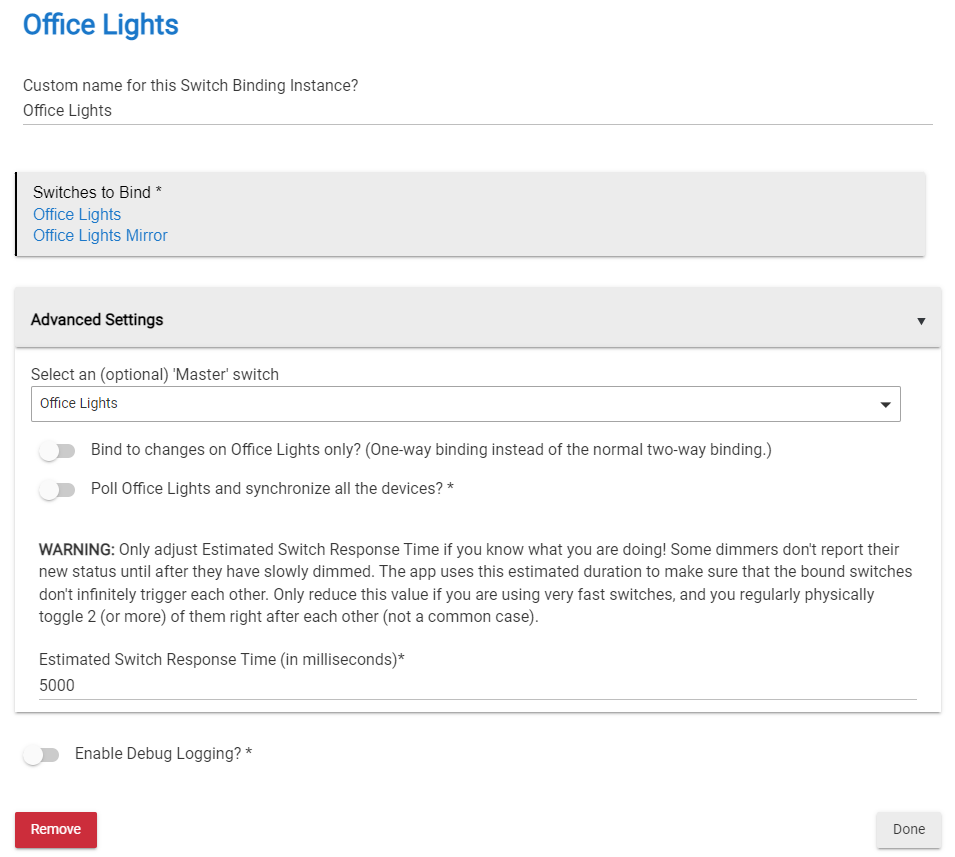

What is the best way to fix it for now? I currently have it working with two mirrors. Is there a better way I can use?
I think you are right to make two because they only go one way. I searched around a little, I thought there was an app more geared towards virtual 3-way setups but I cannot find it. Maybe someone else that uses one can give some better input.
@andrewf329 After more searching I finally found the app that would possibly work better/easier for you:. This app is purpose built for what you want to do.
I just set that up and it seems to work perfectly! It might be my imagination but it seems like it has a faster response time too.
just had the opportunity to try the latest firmware for zen77 and couldn’t discern any difference with just direct association - so I removed the association and tried the binding app … which didn’t work at all. I went to another virtual 3-way set of switches that still had direct association and created a binding for those and it worked perfectly (dimming, double tap, etc)
@andrewf329 is that the same config you’re using?
You mean you used the binding app AND the associations at the same time? That should not be needed, the app should work without any associations. I have never used it myself but I have seen it recommended before, I think a lot of people are using it.
Correct binding and zwave direct association at same time. On two switches with no association the binding alone did nothing at all… that’s why I was asking if they were expected to be used together?
EDIT: i just tried w virtual 4 way (3 switches)... when both aux switches are direct associated to the load controlling switch and in the binding instance it gets into a loop... and removing the direct associations like before renders the binding alone useless. Looks like it need more experimenting.
I'm not using associations anymore, only Switch Bindings. This is the only setup I did and everything works including multi-tap.
EDIT: Forgot to mention, I'm using ZooZ ZEN Dimmer Advanced drivers.
Thanks for confirming- same driver here as well. I’ll have to give it another go sometime. I too had played with the mirror app setting in both directions like you did but had looping issues that way
