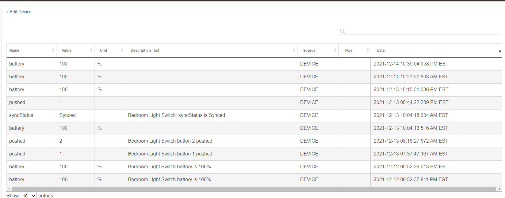

The new one I installed on the 9th with version 1.03 firmware, reported battery status 1 time the next day on the 10th, about 50 times on the 11th and about another 50 on the 12th. I switched it to the custom driver, on the 13th. It made two battery reports that day about 12 hours apart it did the same on the 14th. It has yet to report battery status today.
I went back and tried the custom driver posted here again. This time I actually paid attention and when through it's setup procedure ("Tap Up x 7"). So far, it's gone through two reporting intervals (12 hrs) with only one battery event for each.
Perhaps the other drivers are not properly initializing/setting up the Zen34. I'd assume the device needs to be awake to receive the setup, and the procedure the custom driver does ensures this. So, hitting "config" with the other drivers at some random time may not actually be doing anything.

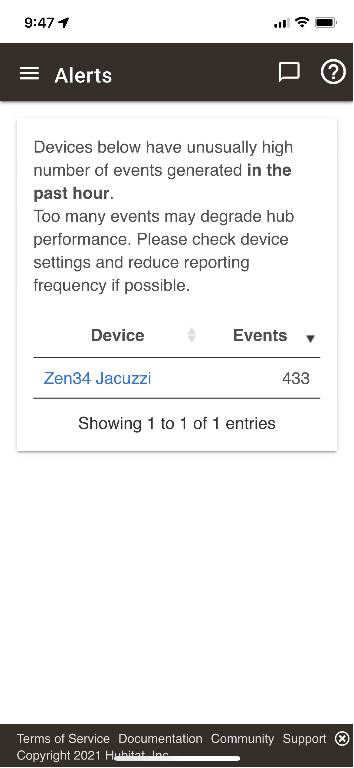

Using the custom driver now for the past week and everything seemed to be going well until this morning. I woke up to this
When this happens, it slows the zwave mesh to a crawl. Luckily, nothing mission critical relies on zwave in my house.
And yes, 433 battery reports in 1 hour. I replaced the batteries 2 weeks ago with new Duracell 2032s because the previous continuous battery reports killed the batteries. I really want these to work out, but I’m going to have to get rid of them if this problem can’t be fixed.
EDIT: After posting this, it’s now over 500 events, so off I go to try to get it to stop. Batteries are still at 100% miraculously.
EDIT 2: Pressing one of the buttons seems to have stopped the reporting for now. I have been using these daily, but they’re in the Master Bathroom, so they don’t get a great deal of use.
EDIT 3: This is on a C-5 with 2.3.0.121 firmware. Other z-wave devices (only using z-wave plus) are rock solid and the Zen34s are very responsive, so I’m pretty sure it’s a device issue.
