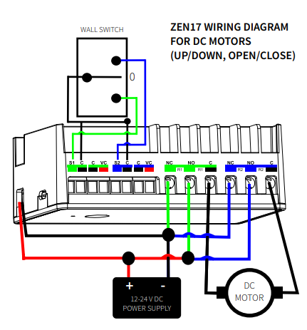

The ZEN16 manual does not show it but the ZEN17 manual shows sharing a power source with the devices.

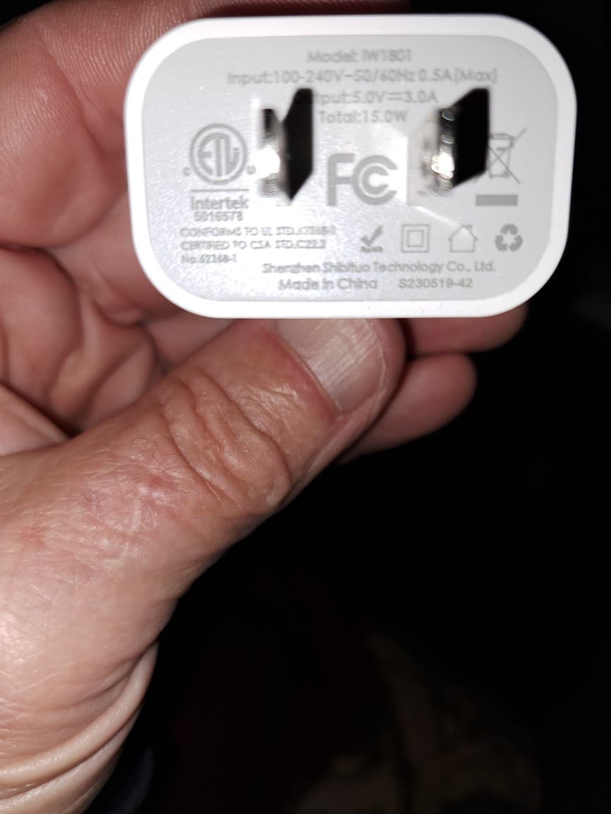

How about something like this? I think I got it on Amazon.

I have been using that 3 way plug in the picture to power a ZEN16 and a Zooz ZSE18 motion sensor for a while now with no problems. I think it's pretty basic.
