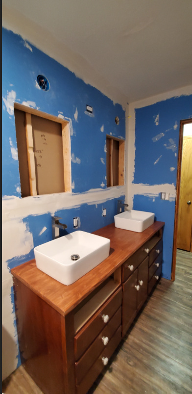

Thanks for all the input on that. The one on the bedroom fan light I heard when I was walking by. It's that loud. It's from the switch and it's a low voltage built in LED light. I don't think it can be changed out. The buss is more quiet when the light is on. The one in the bathroom is notably more quiet. I can hear it if I pay attention to it, but I don't have to put my ear next to it either. We're anticipating two light fixtures to be added to that switch in the next few days, so I'm curious to see if it will subside.
