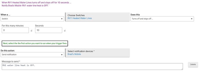

I have a Basic Rule set to "When a switch turns off and stays off for 10 seconds --> Send notification to mobile device".
This rule only works if I use the on/off switch on the power switch. Is there a way to get it to send the message if the wall outlet loses power?

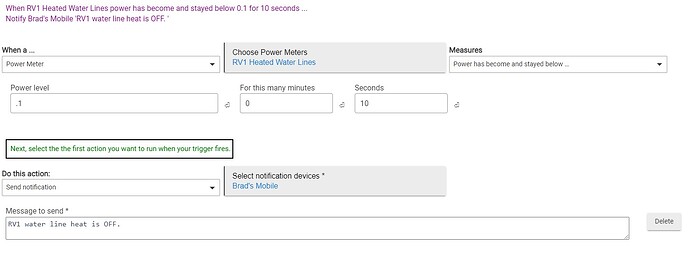

It is a ZEN15. As pointed out below, it doesn't work if the plug has no power. Here is my rule:

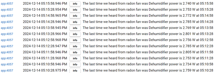

It turns out the way I do the radon fan is spanned over several of my rules that work together. So let's just create a test example. I'm using dehumidifier instead because it is a ZEN15. Ignore the cosmetic "radon fan" in the log message; I forgot to change it.
Setting power reports on the Zooz Power Switch at 30 seconds, I then create a rule as follows
which results in
It is left as an exercise for the interest student to have this rule set a hub variable LastTime or something that is set to %now%. Then create another rule that runs every five minutes that compares LastTime to the current time. If it is more than two minutes, alert you that the power switch isn't reporting in.
This is a bit kludgey. It assumes that the power will vary by one thousandths of a watt every 30 seconds. I thought there was a way to trigger in when a power monitor reported anything regardless of value, but that escapes me at the moment.
Also, don't go nuts with the frequency of the power reports. They can create a lot of traffic, especially if you have more than one. I think one device reporting in every 30 seconds is OK.
