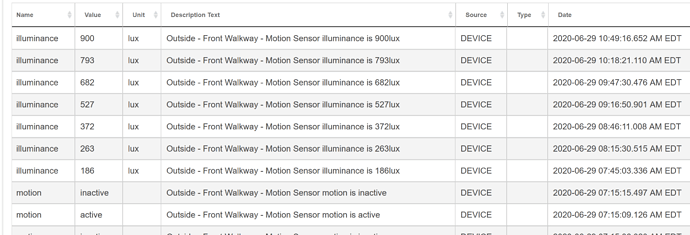

here ya go
and you can see I have gotten no motion events since 7am
