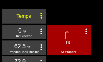

It's been hanging around at a low battery % for a while now.

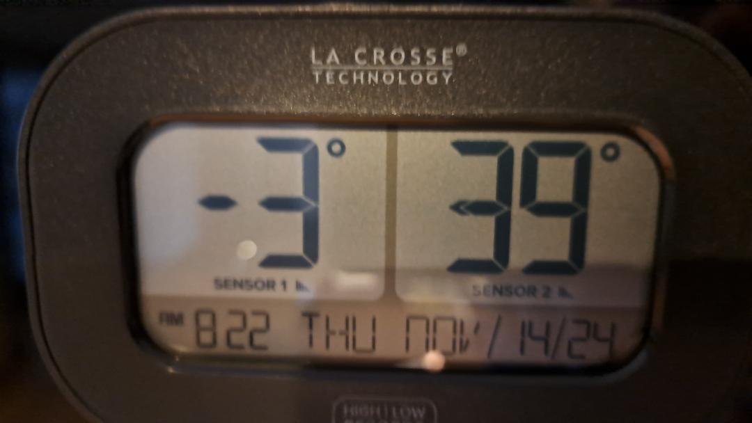

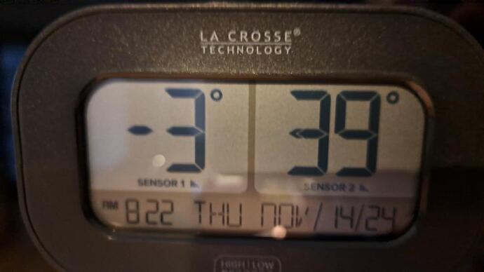

My LaCrosse dumb wireless thermometer says -2F, while the ZSE44 says 0F.

The battery in my freezer sensor died yesterdsy. It lasted a month. I'll put a new battery in and put it in the fridge compartment and see how long it lasts.

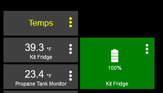

Well, after I relocated the sensor to the fridge, with a new battery, it's down to 14%.
Preliminary Conclusion: Not suitable for freezer/fridge.
