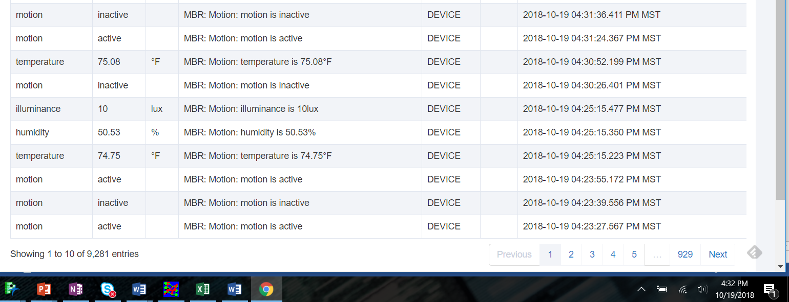

I was toggling the sensor to create most of these. Missing are the corresponding actions.

Here you go.
What am I missing? It doesn't seem stuck based on that. It's sending both events, with inactive a variable number of seconds after active --> which is to be expected.
What makes you think it's stuck?
The logs show that those events are coming into the hub from the device.
You aren't seeing all of the times I triggered the sensor that happened. Note the 6 min since it went active, there has been no motion
I walked into the room @4:30 and it sent the inactive,not active since it saw motion. I walked out, waited a minute 4:31, walked back in and out, and it went active and inactive properly
Does that help?
