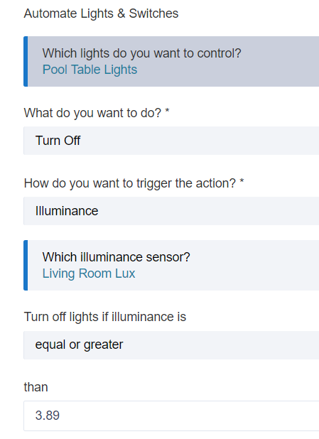

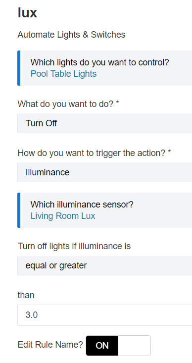

Got my new Zooz 4-1 in today. Paired up right away, getting a reported Lux of 2.95, however I am seeing this error in the log when I turn on another light to increase the lux based on my Simple Lighting Rule and the target light is not being turned off
Here is the Simple Lighting Rule
And why this message? Is being asleep an issue? The only way so far to wake it up that I have found is to use a paper clip and press the reset button (also indicated in the log file)
What am I missing?

Illuminance is 3.88
I have a simple lighting rule set to turn off a light when illuminance is >= to 3.9
Turn on said light, nothing happens
The illuminance takes several minutes before it changes and when it does it now reads 35..9, yet the light doesn't turn off
Still getting this error in the simple lighting rule log which i think needs to be solved first, it appears to be the issue
I'm sure i'm missing something very basic
Rick
I wonder if simple lighting doesn’t like float for illuminance.
Hey napalmcsr
Looks like you might be right. I removed the simple lighting rule, created a RM Rule and now it works.

Yes, Simple Lighting is using an integer for the lux field. That could be changed to decimal.
Both RM and SL use integer for lux values.
We shouldn't be reporting Lux as a decimal.
Well get this fixed in the driver.
