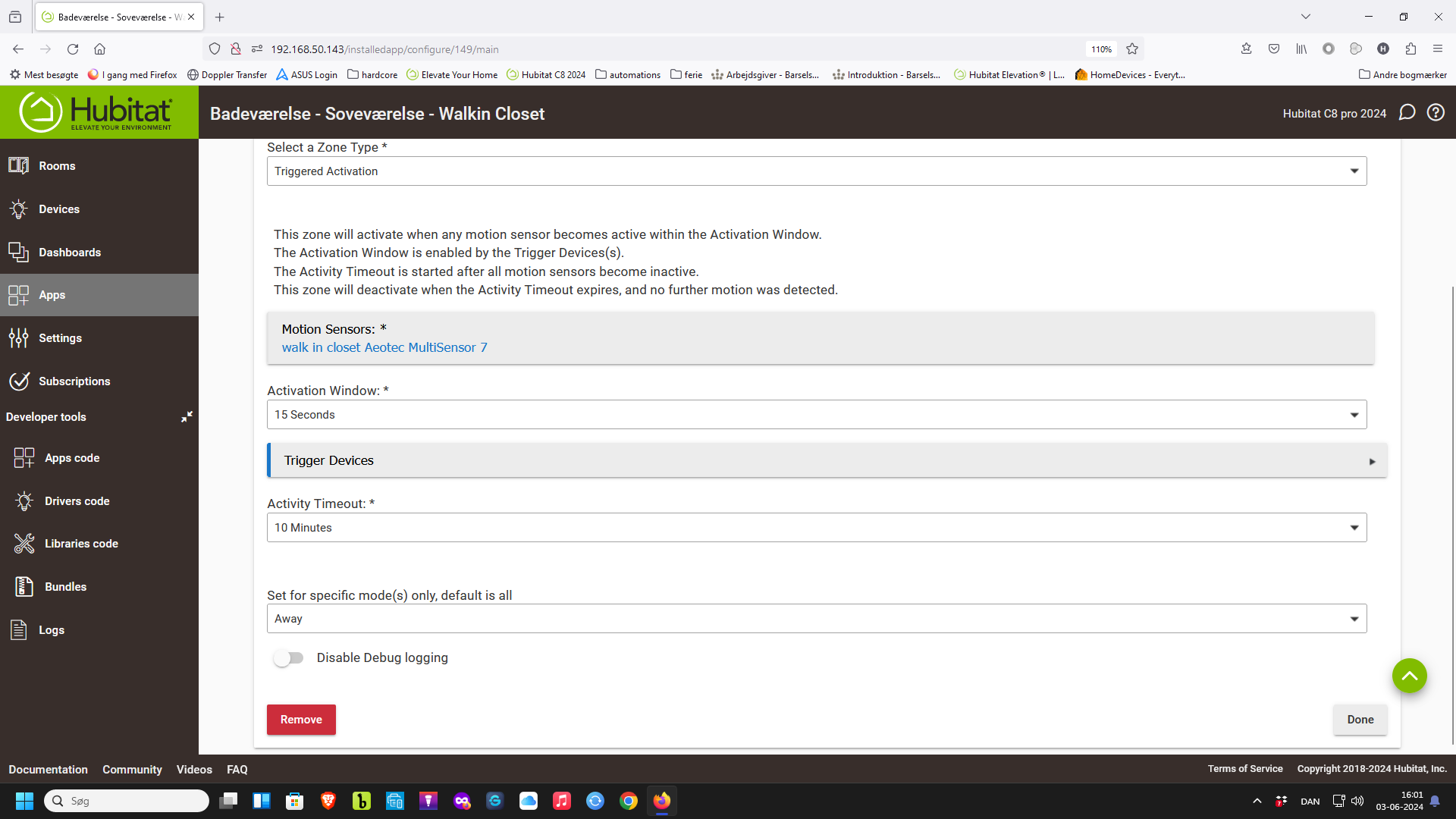

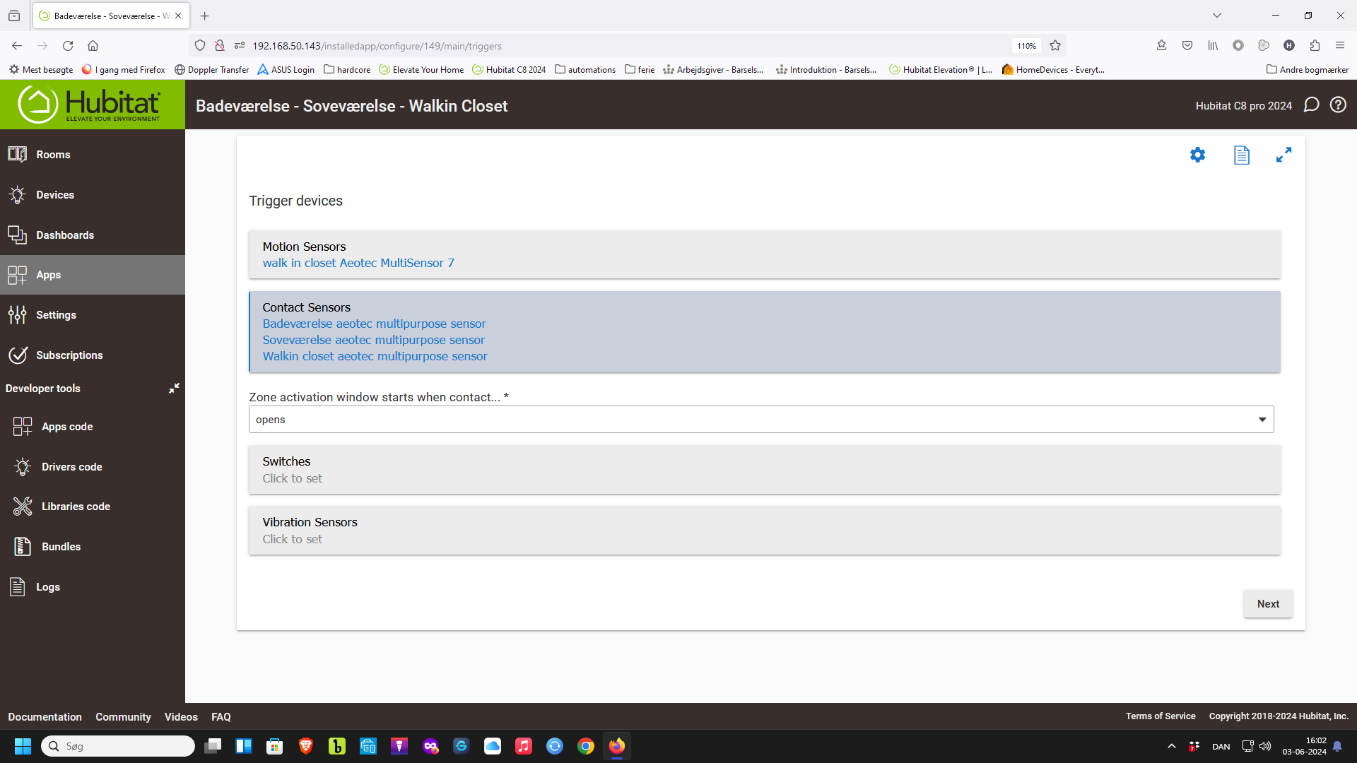

So I have created 4 zones as Triggered actions
as an example: so I picked 2 rooms together with a total of 3 motions sensors 15 seconds window
as trigger devices I chose same motiosn sensors and also 2 window door comntact sensors with a 10 min activity timeout
I did not pick any switches or or anything else
I do have 6 hue spots in 1 room and 1 hue aurelle panel in the other.
so these are my questions:
1: is it a problem to pick the same motion sensors again as triggers together with the contact sensors?
2: what about the lights? I want hese zones to turn on the lights, I can pick the lights as switches, but it dont make any sense to me to pick that, as they can turn on or off.

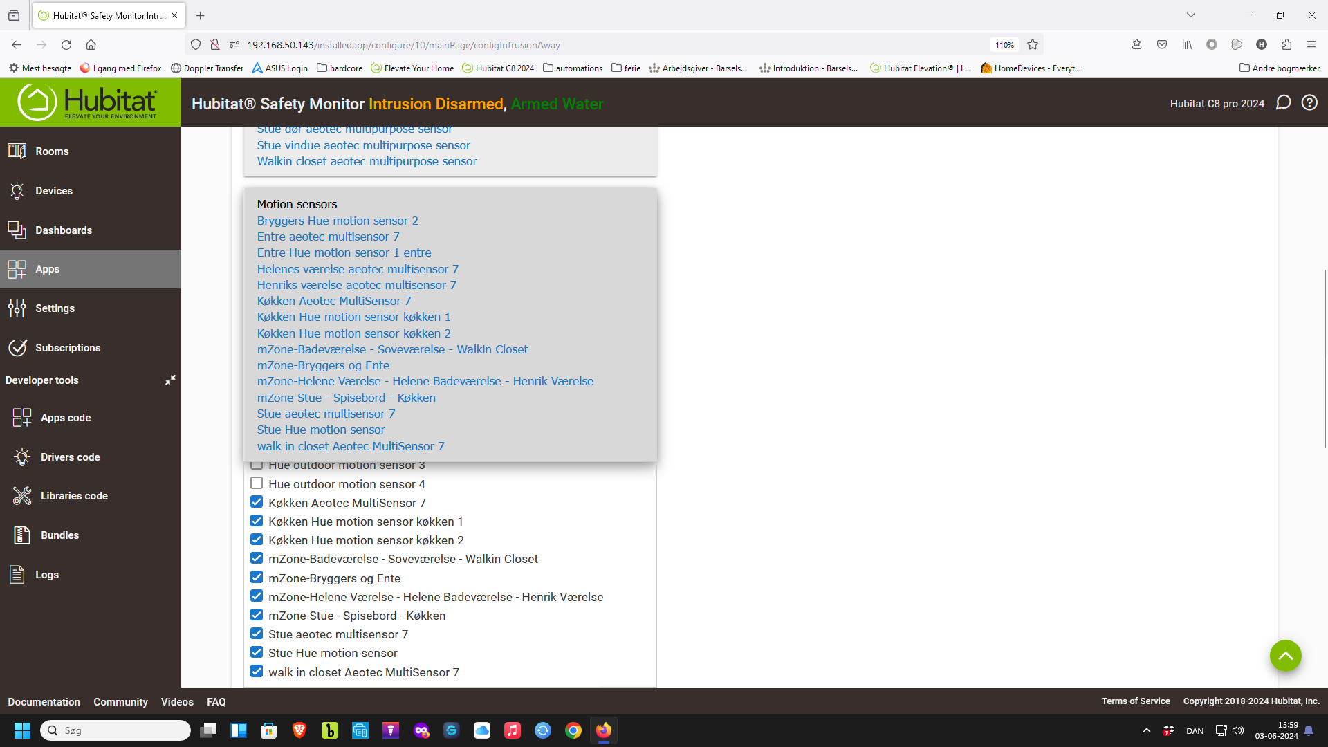

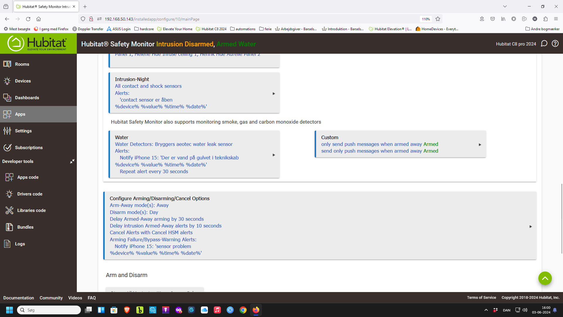

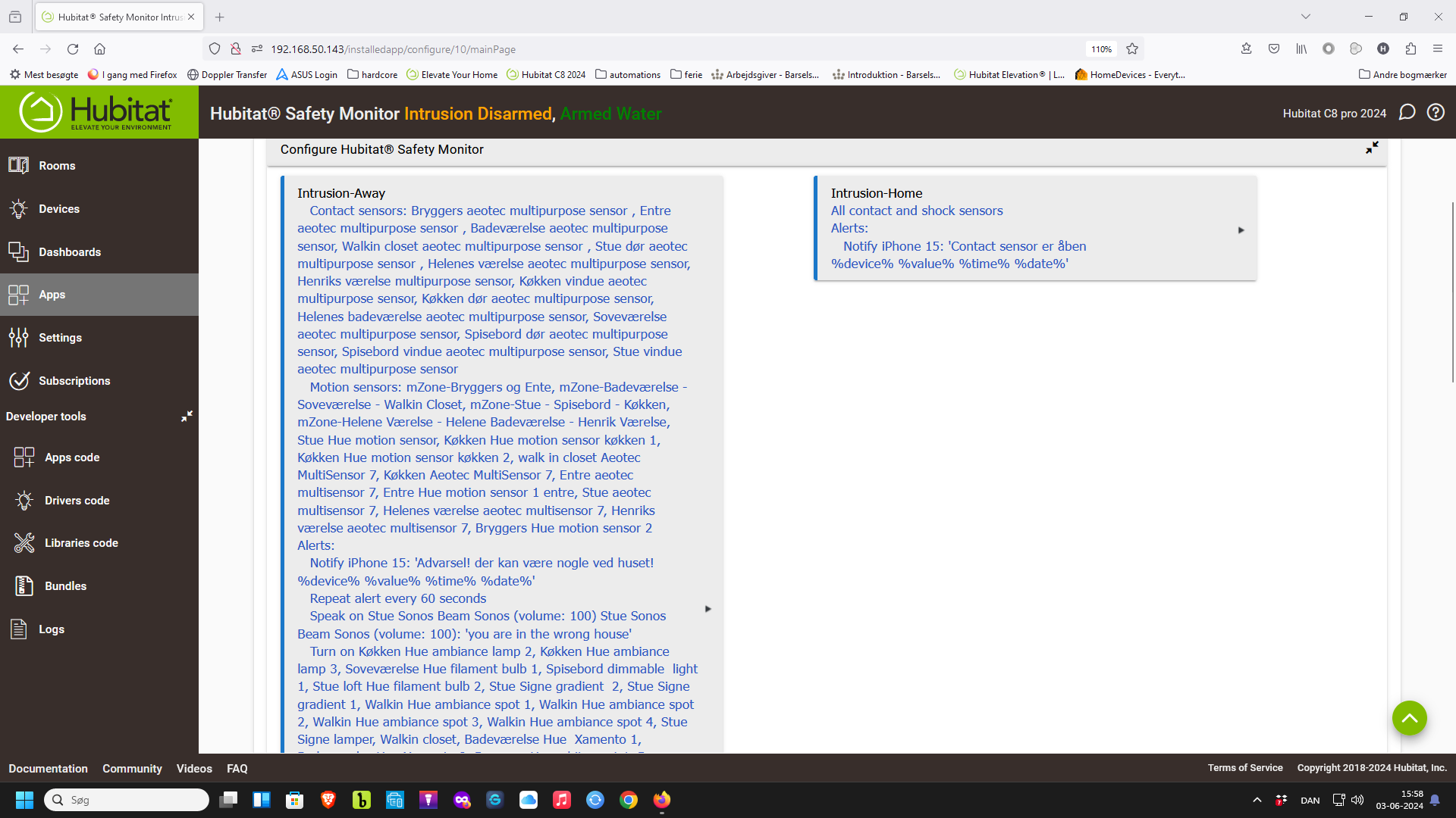

3: so I wanna bring these zzones into HSM under intrusion away, I can add these under motion sensors, howevere how will these zones interact with the lightings added in HSM, can the zones figure out the lights connected to the motion sensors and contact sensors,which I added into rooms when I got my box.

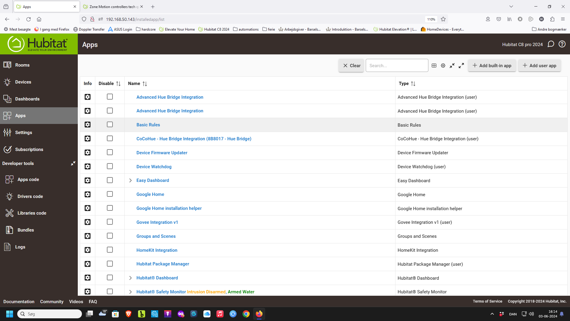

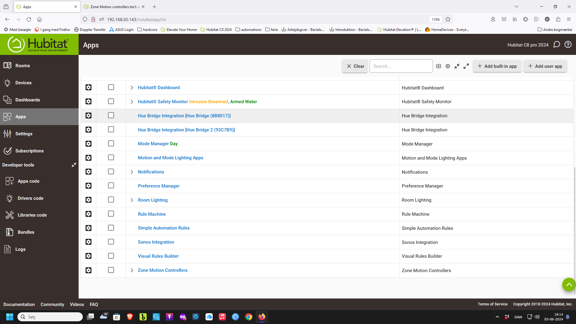

thanks you gor gettinga back to me, Ive attached all screen shots, let me know if you wanna see something specific. I have 2 hue bridges added one for indoor lighting and one for outdoor lighting.
Im unsure if I can pick the same sensors again again as motion sensor in the room to alsos used it as a trigger sensor, I would assume you can ofcourse.
But I do have no idea of it will turn the lights on or not vand also reset after the 10 min time out, I dont see that clearly. But will look into room lighting as well, but gotta read the documentation first, Ive attached 7 screen shots to see, if you wanna see more, let me know

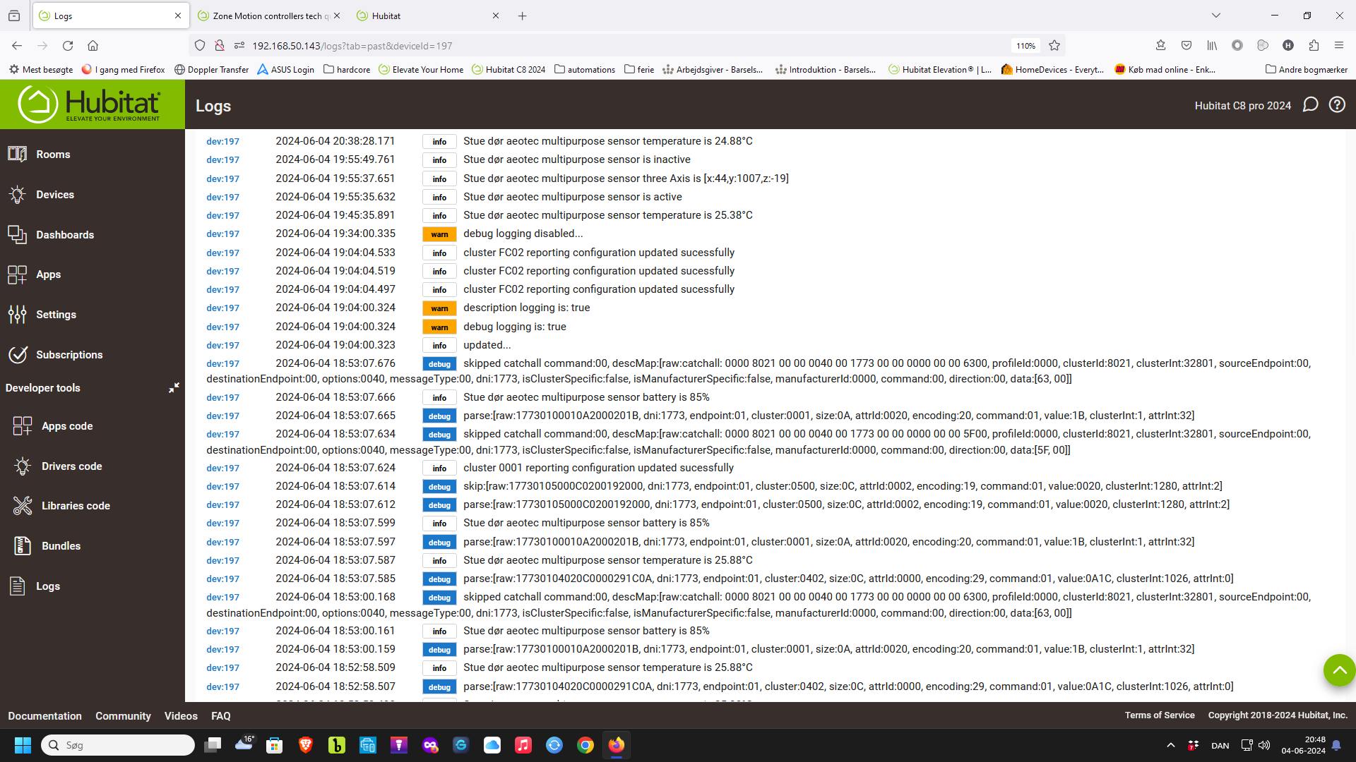

anyway heres a pic of a contact sensor log

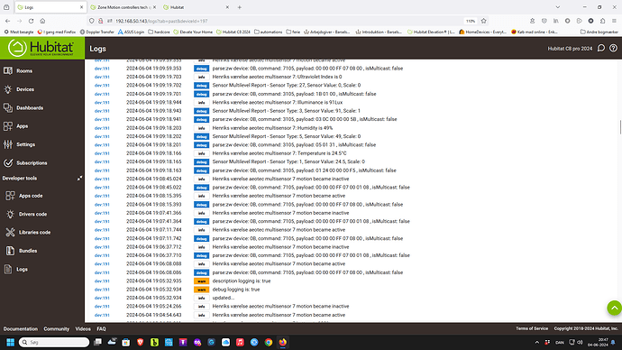

and a multisensor 7 log
I do also notice when I go into devices and pick one, it sems to disable debug logging on alot of teh devices, I have enabled it for each device saved preferences and save device, but seems like it disable all my aeotec multisensor 7 devices and also all my aeorec multipurpose contact sensors?
