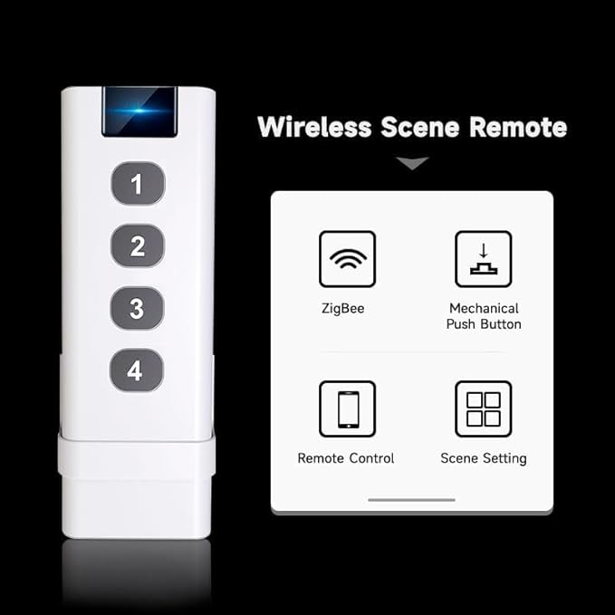

Pairing Zigbee 3.0 Scene Remote button, Tuya Smart Remote. This was listed on Amazon and had a comment that it works with Hubitat. I was trying to pair this. It picked up, but as a generic "device." Here is the fingerprint for the device:

I found the Tuya Zigbee Scene Switch driver in the list and set that as the driver. Hopefully, by providing the fingerprint, the driver can updated to recognize this device upon pairing. I have not done more than pairing so far, In theory, this can support three actions per button--tap, double-tap, and hold. How well it works, I will find out.
