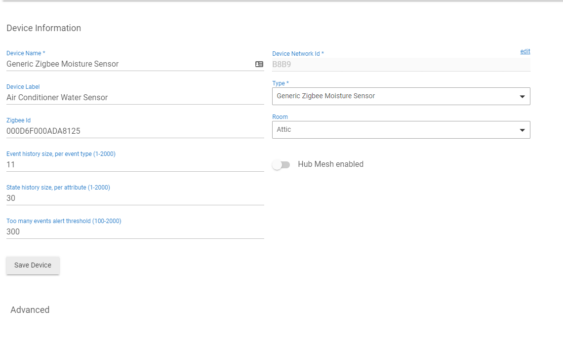

If so, what does one look like on the device page? (can you post a screen shot)
Aside from all the other good advice in this topic, have you tried doing a test of the leak/water sensors? I have found that sometimes it takes being triggered to have the attribute report correctly. Take a damp paper towel and touch the leak sensor area and see if it starts reporting the status. Also, make sure you're using the right driver for your devices. Maybe you're using a non-leak sensor driver that doesn't support the correct capability. As was requested, a screenshot of the device page details for one of the non-functioning devices would be useful.

Posting a screenshot below as requested, but I have pretty much acquiesced that I am likely going to have to touch each one again.

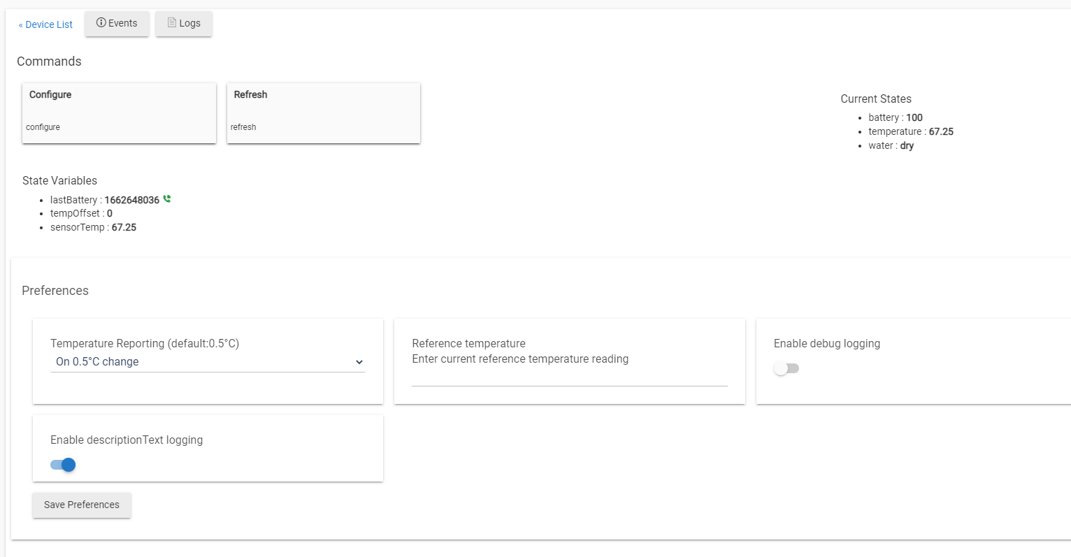

Here's the rest of the screenshot for the device details including the driver you had asked about.

That looks like the correct driver.
