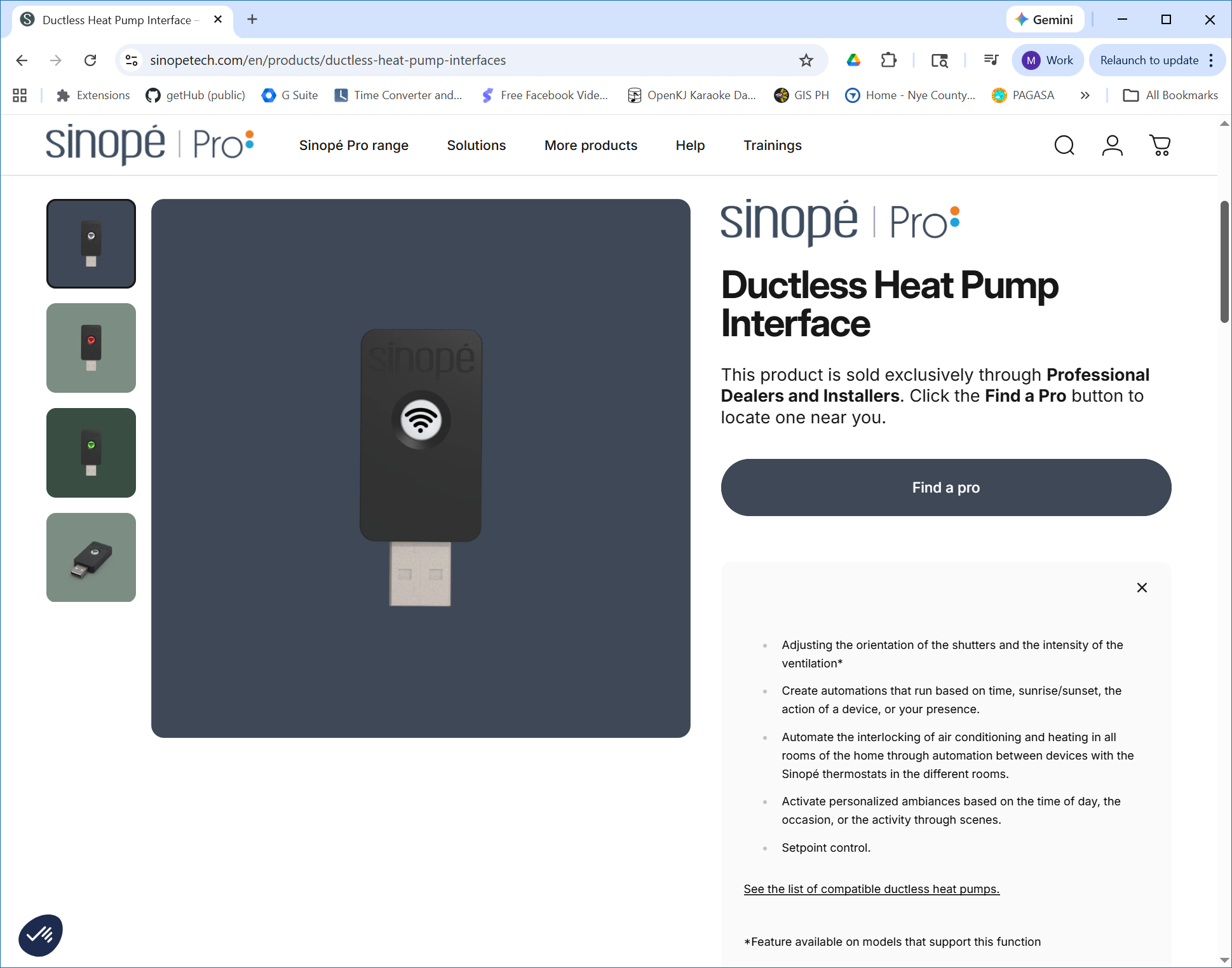

here's the best part about that device:
That it is only available through a Pro ? I know, but it's ok (for me anyway), I can get one through my heat pump installer.
By the way, that one is the Wireless version. They have a Zigbee one.
they're quite sketchy on what you get outa this thing...
yeah I saw the zigbee version
Well, the official initial answer is that the heat pump solutions are only compatible with their own interface Neviweb. That's sad considering how well things have worked between Sinopé and Hubitat in the past...
Hopefully you get a better answer from your side. I did point the customer support person to this thread.
