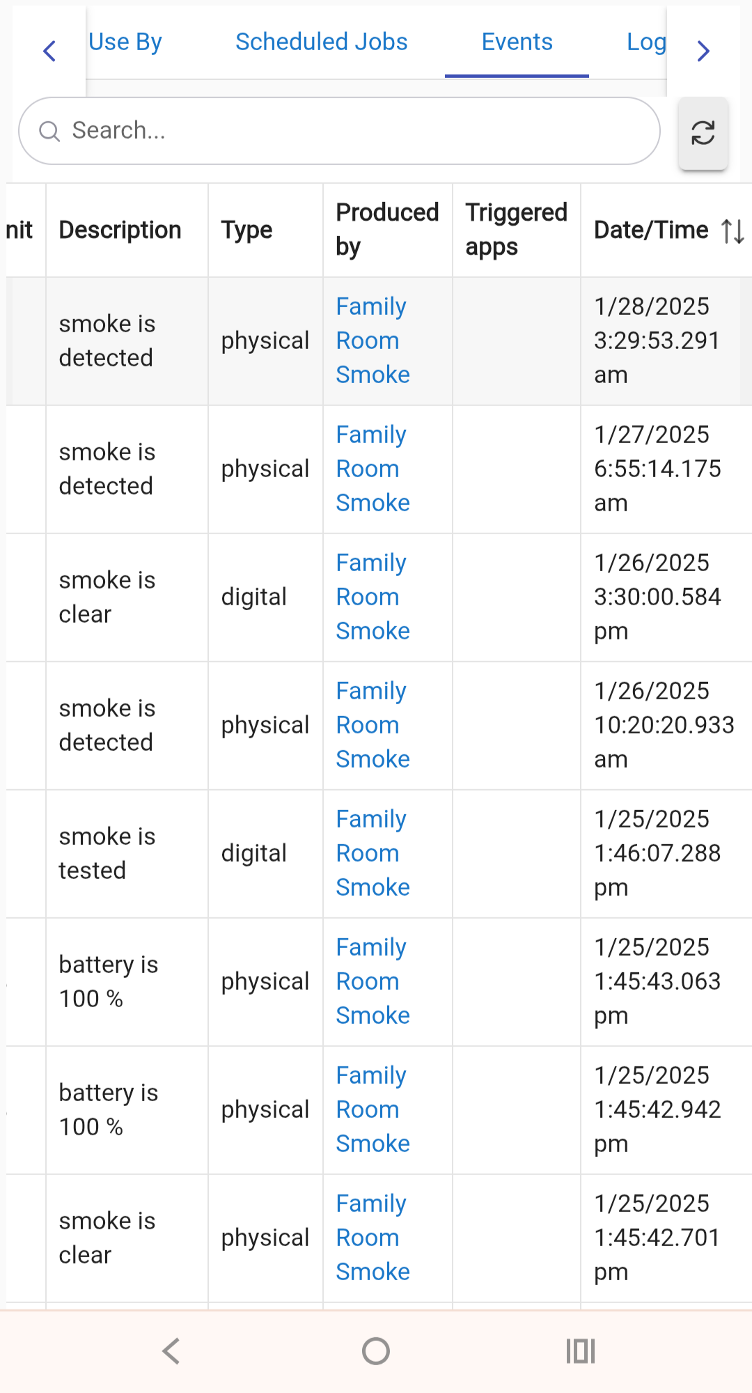

Anybody using these zigbee smoke detectors? They keep showing smoke detected but no alarm. I've cleared them but detected keep returning. Is this normal?

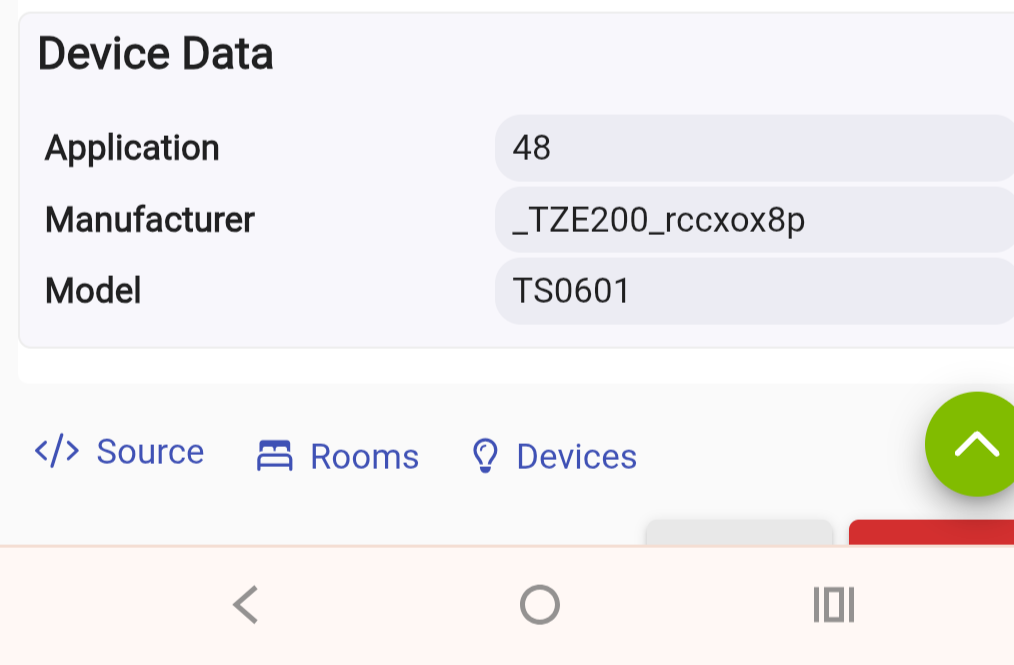

It is not possible to identify a Tuya device based on a picture only, very often one and the same plastic cabinet is used to fit different firmware versions made by different manufacturers, different models and sometimes even different type of devices..
Please always specify the Zigbee device Model and Manufacturer, as identified in Hubitat (the information is available in the Device Info tab).

(enter the Manufacturer identifier as a text in the forum search field). Are there any references for this device, or it is a new one?
I am not aware of any other driver for Tuya TS0601 model smoke detectors ...
Some Tuya devices, especially TS0601 models will work very differently depending on whether they were initialized as expected during the pairing process or not. Any further Configure/Initialize commands do not have any effect. The right driver should be installed before the Tuya TS0601 device is paired to your hub.
So, pair it again (without deleting it).

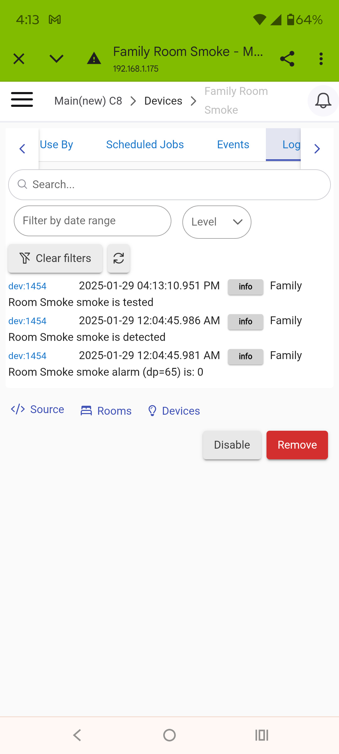

Anything in the live logs when you press the TEST button on the device?
Yes 1.2.1
Just tested
