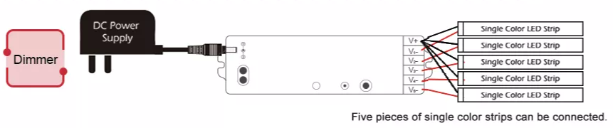

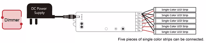

I have no experience with this module, but I took a swing at the Gledopto site to learn what they might have:
