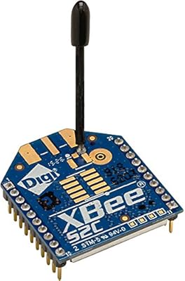

2 xbee installed, one in garage and one in house, seems to work a treat. Rssi is -74 and switches in garage have been reliable so far.

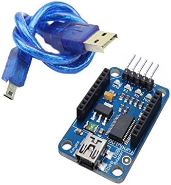

I ended up getting some xbee2 units from mouser and usb adapters off amazon.
Configured as OP and worked straight away. Although it's a bit odd as the xbee never seemed to complete pairing with hubitat, but after initialization they seem to be working and doing the job.
As a bonus i no longer need 2 of the the switches that were used as repeaters, more automation opportunities lurk.

I did not need any driver infact the device pairing never got beyond initialization so I have no device on the hub anyway. I have seen some oddly named devices in the zigbee logs. As long as the xbee has attempted to pair it seems to be able to take care of itself.
It took all of 10 minutes, hardest part was the sourcing one. Mouser have xbee2s available, which seem to do the job. It's also intriguing to watch the mapping happening when xbee scans your network and is connected via the xctu software. So far i would recommend if you have zigbee issues.

no driver is required for an Xbee to work as a router for other devices,
it will simply appear as a "device" in the Hubitat device list.
It maybe possible to create one for an Xbee3 in the future.
