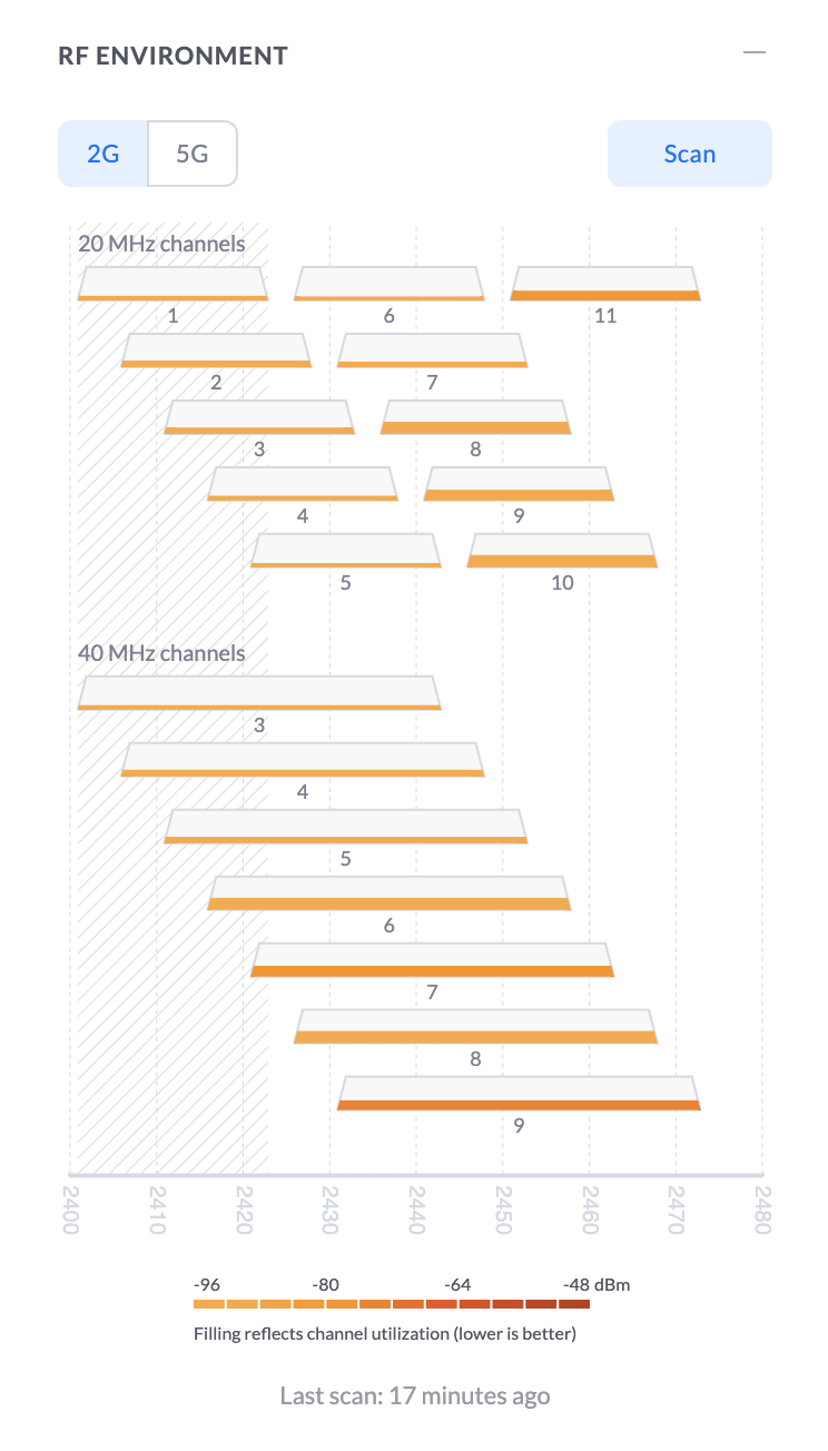

- I'm on channel 20 for my Zigbee mesh. I WAS on channel 6 for my Loft AP, and channel 11 for my basement AP. I just changed the Loft to Channel 1, because it looks like it is pretty close to Zigbee 20. And channel 11 definitely overlaps. Here's my RF environment:
I'm thinking that if I change my basement to channel 6 that it might help, and then change the Zigbee channel to 23 to keep it as far away as possible. Thoughts?
Edit: Based on my interference on my RF chart above, maybe I will leave the basement on 11 since it's working fine, change the Loft back to 6, and then set Zigbee to 12 (which overlaps the lower part of wifi channel 1). I also noticed that bluetooth devices use 2450mhz, which is channel 20 on zigbee.
