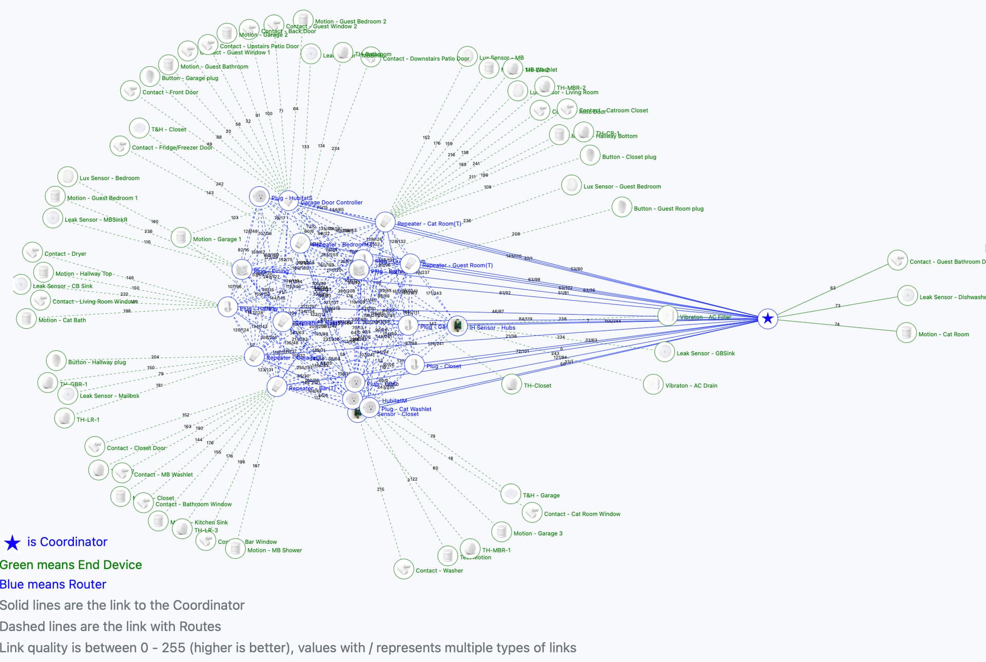

Multiple routers make for stable meshes. I have about 80 zigbee devices on a non-Hubitat zigbee coordinator that lets me visualize the mesh. This mesh has been incredibly stable even through power outages for 1-2 weeks. I think I have about 20 routers in that mesh.

That’s approximately half the total number of devices. What can I say - I like lots of sensors and automation :pensive:
Two zigbee networks - one Hubitat, one non-Hubitat. One zwave network. Most automations through Hubitat.
How did you generate this chart?
I thought only one router could be traced with Zigbee.
That is not a Hubitat network. I just used it to illustrate that a sufficient number of routers can stabilize a zigbee network. This network is my zigbee2mqtt mesh. With HADB and/or Node-RED, zigbee2mqtt devices can be brought back into Hubitat for automations.
