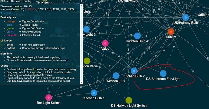

You can tell by running a ZigBee map app (via HPM) like the one from dandanache; it will show you the repeaters.

This as @dnickel notes, is a good way to see, w/default settings blue devices are repeaters:
ZBmini in the remotest corner of my house, doing it's repeater thing.
