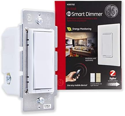

Assuming you're in the USA, perhaps for this one room you could go with an in-wall Zigbee light switch/dimmer instead of an outlet? It should do a decent job as a repeater, and will allow you to control your lights in that room as well.
Yeah, the only one I knew of was Enerwave, but they've now gone all Z-Wave. Sinope has Zigbee dimmers and light switches. No outlets at this time. I think @mike.maxwell added them to the Generic Zigbee dimmer and switch drivers.
I remember this one now. There's something off about it.
Looking at it...it's not clear it's actually Decora compatible. It "kinda" looks like Decora, but that mounting system makes me think it's not compatible.correction -- it is Decora compatible as pointed out further down the thread! (by @aaiyar)
And...as @aaiyar pointed out...it's not clear how Hubitat compatible it is.
Questionable Provenance...or in this case questionable design....
