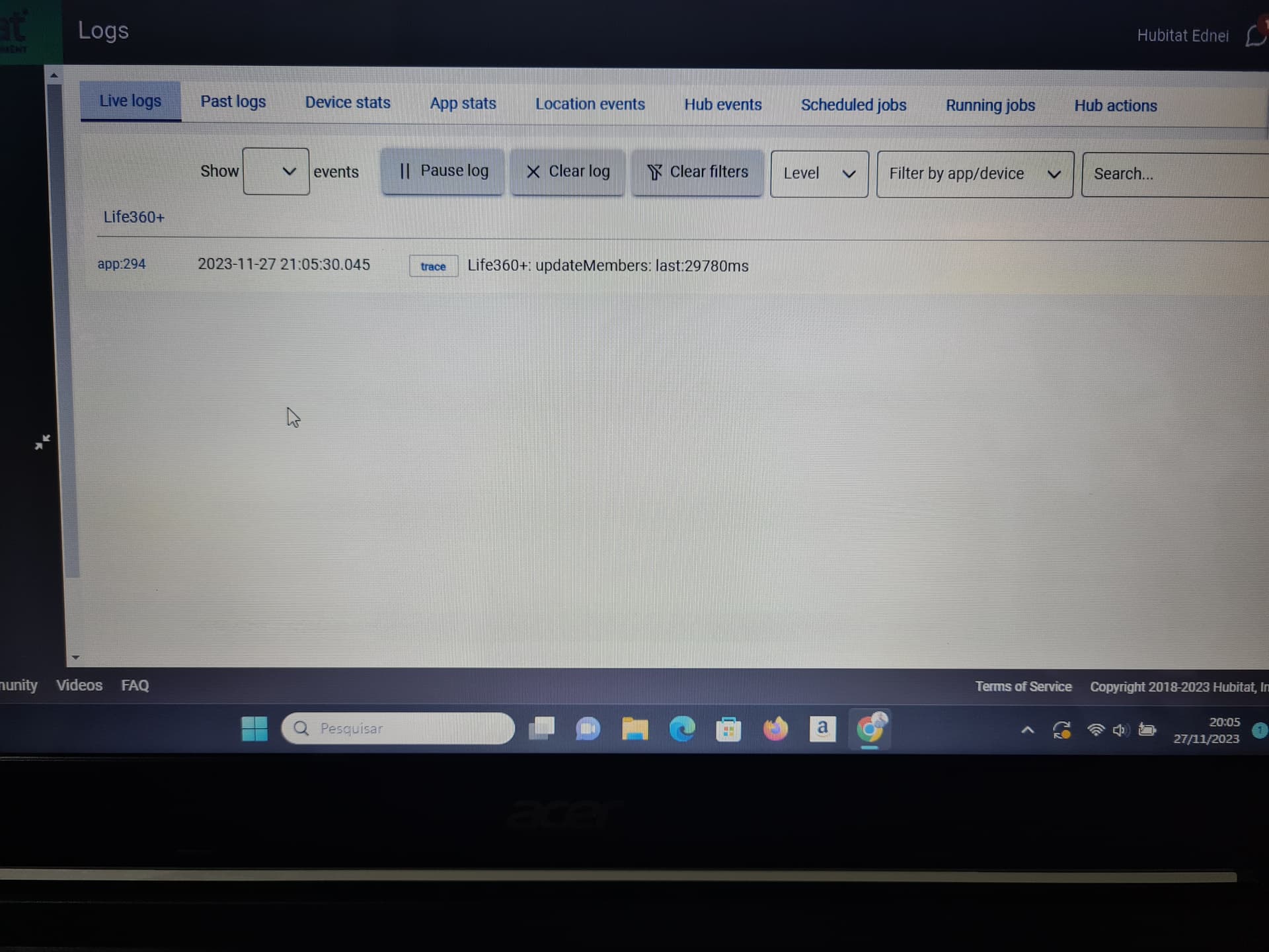

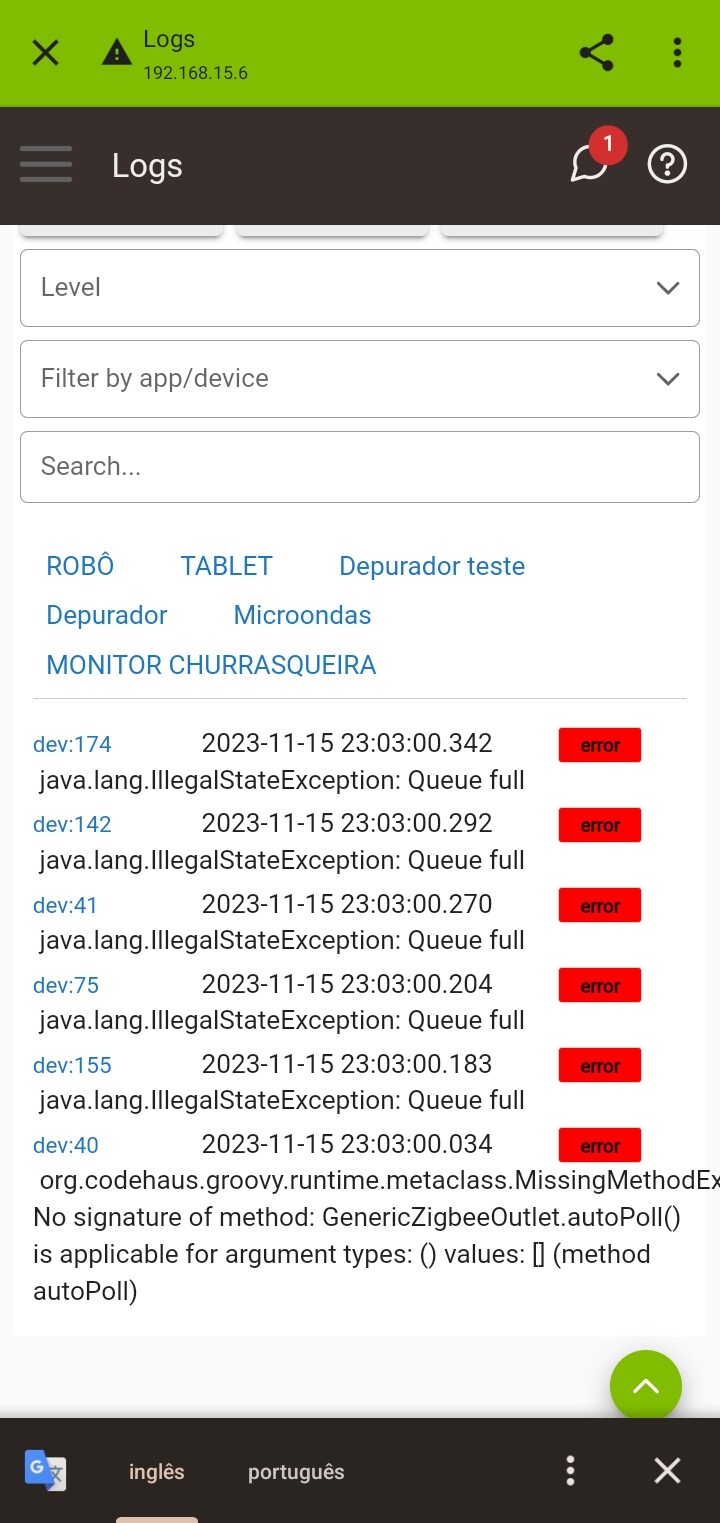

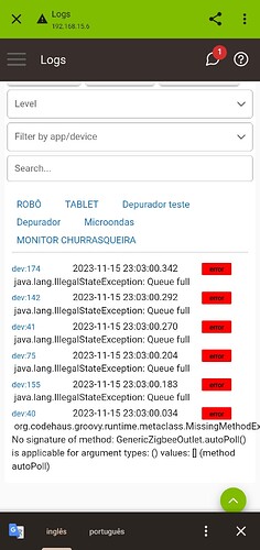

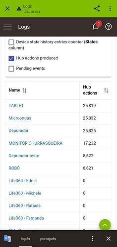

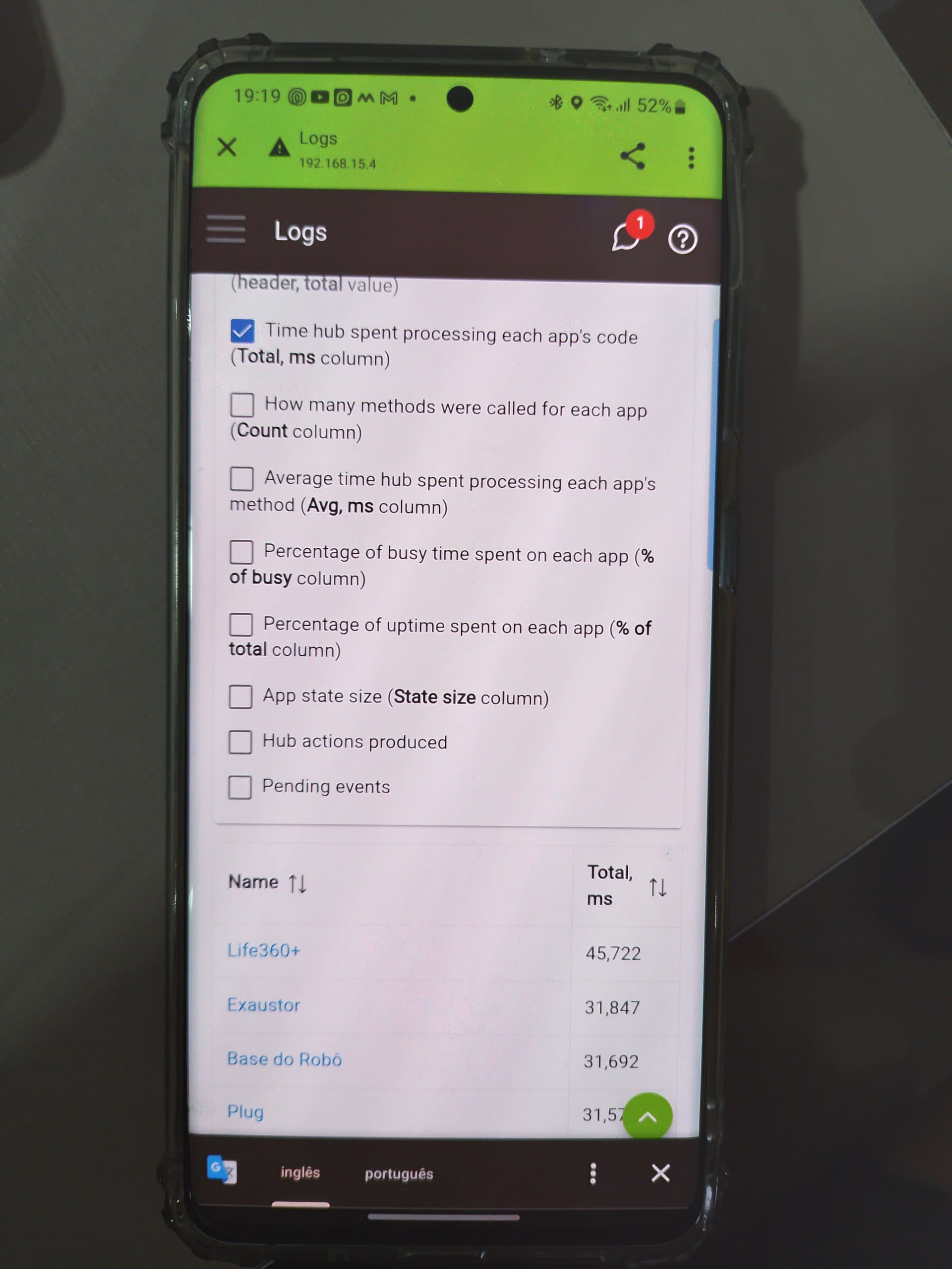

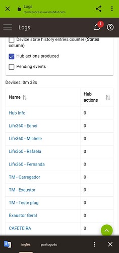

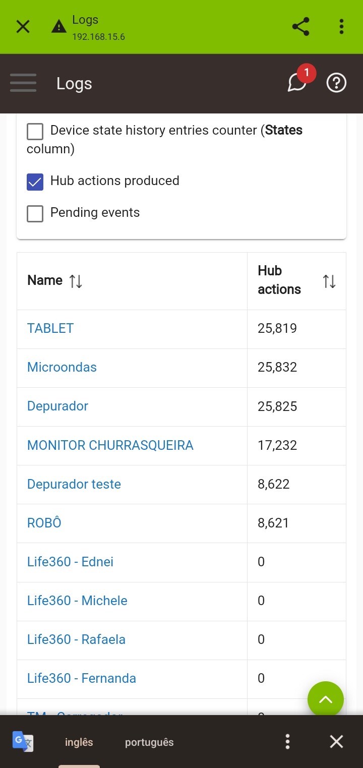

My hub is a c7 which is in version 146, through the help of the hubitat group, I saw that some devices were generating a lot of traffic, I tried to make changes to the event history and state of each device, I also tried to make the driver change, I restored a previous version, and I went back to the latest version again, and nothing, I deleted the devices that were causing the problem, now in the log record there is no longer any traffic or error records like in the photos I sent, I am observing that the hub is not working online. I don't have much knowledge with hubitat, but through your help and the group I'm trying to get my devices back, but it's difficult. Maybe it could reset. Tanks.

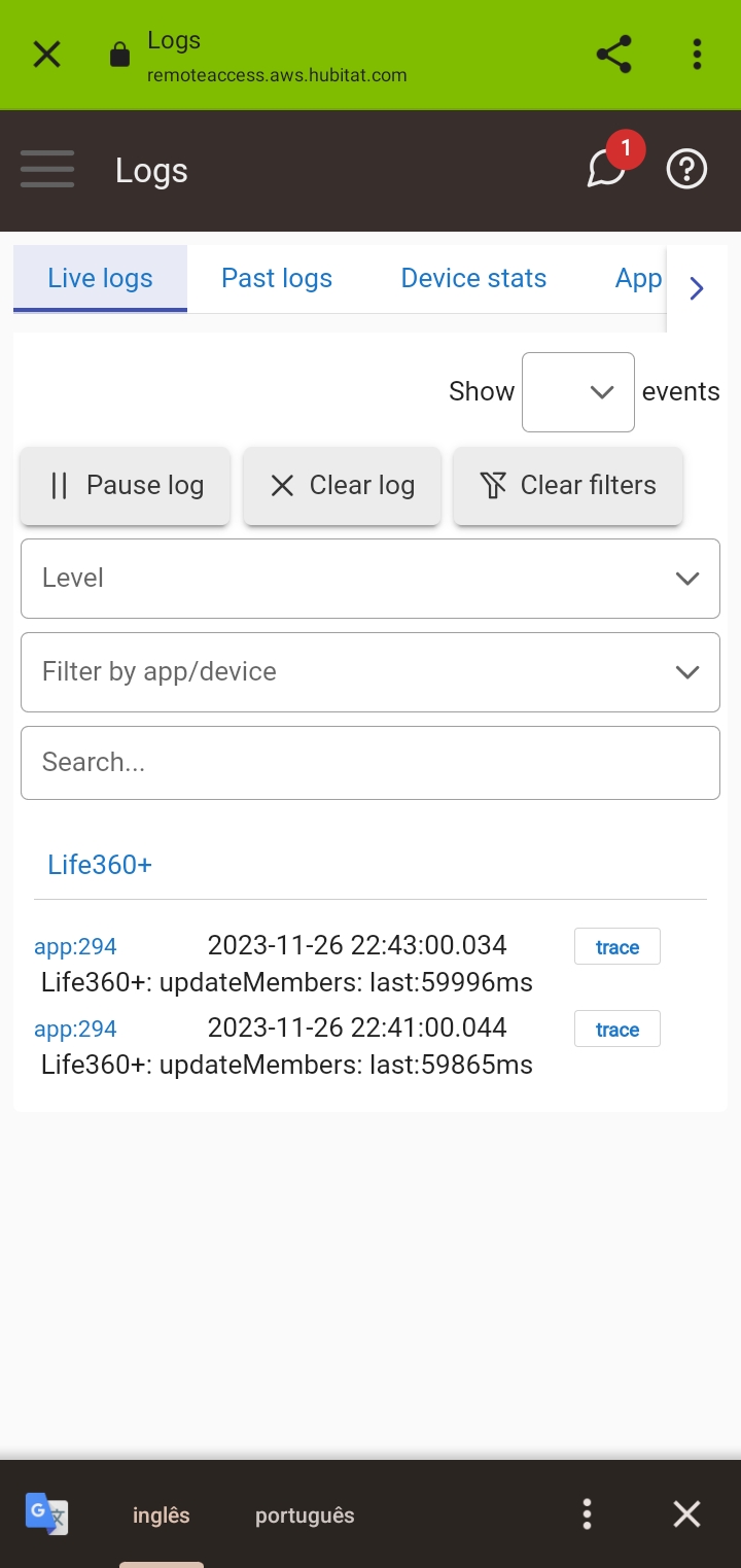

The screenshots are old (10 days ago), do you have any new "Queue full" error messages?

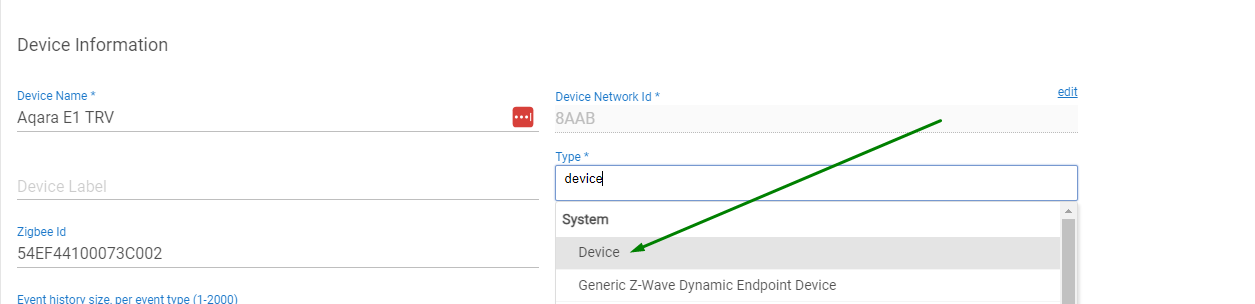

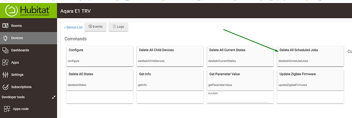

Dev:40 has a scheduled periodic job from the previous driver. You can delete this job using the HE inbuilt 'Device' driver :
For now nothing is working, the hub doesn't go online, I ended up making the decision to delete the devices that were causing the error, the errors disappeared, as you can see in the images, but nothing goes online. I'm directionless.
It looks like you can log into the hub, so something is working. You need to be more specific. Is the hub not able to reach the internet for cloud services? Are local devices (Z-wave and Zigbee) working?

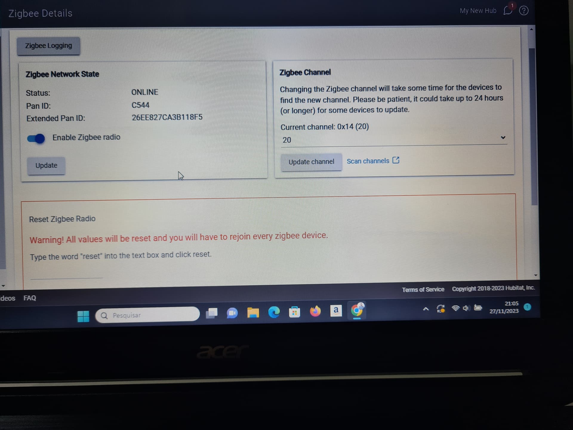

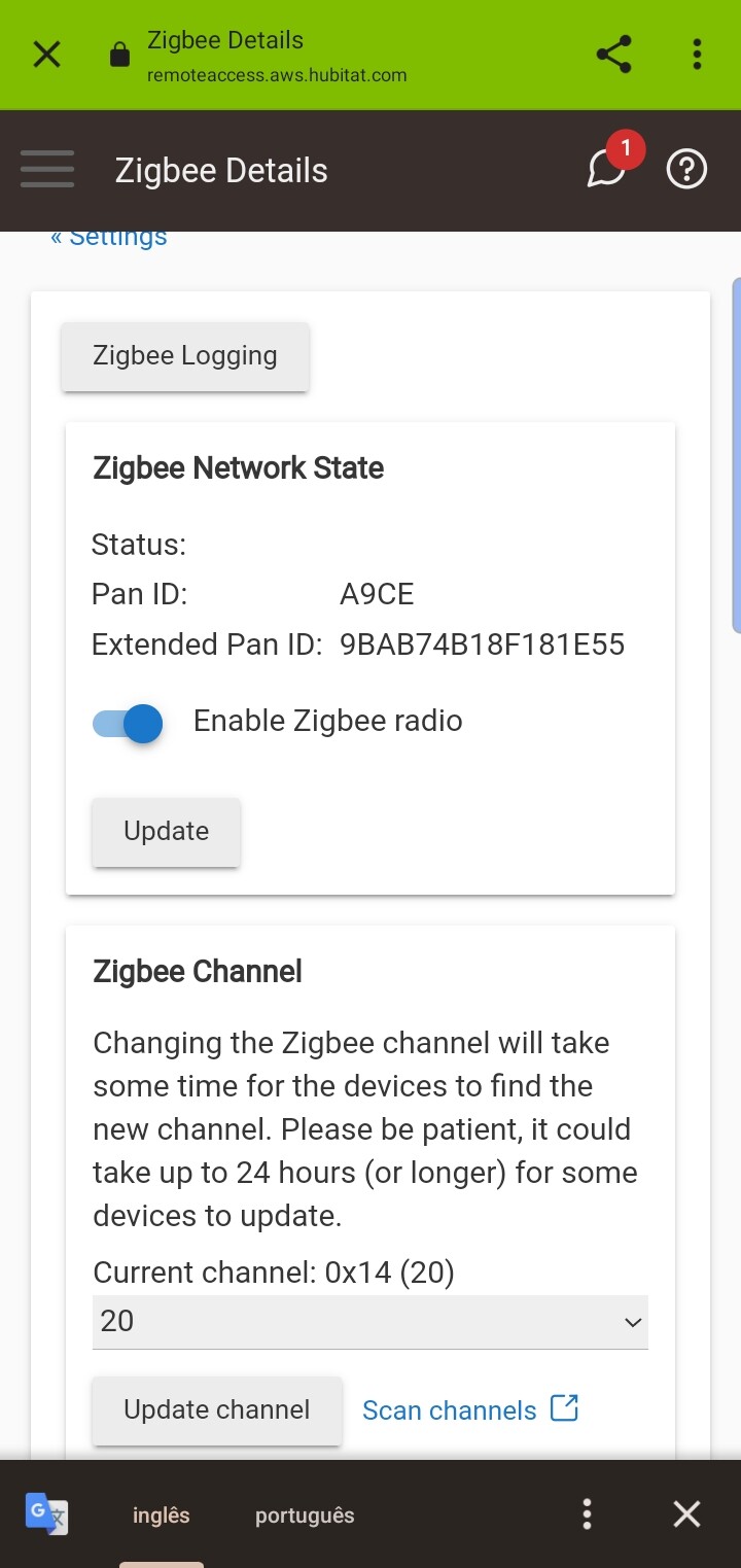

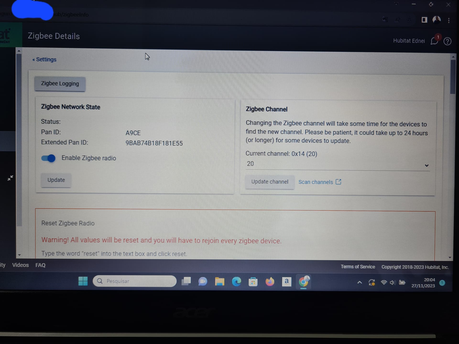

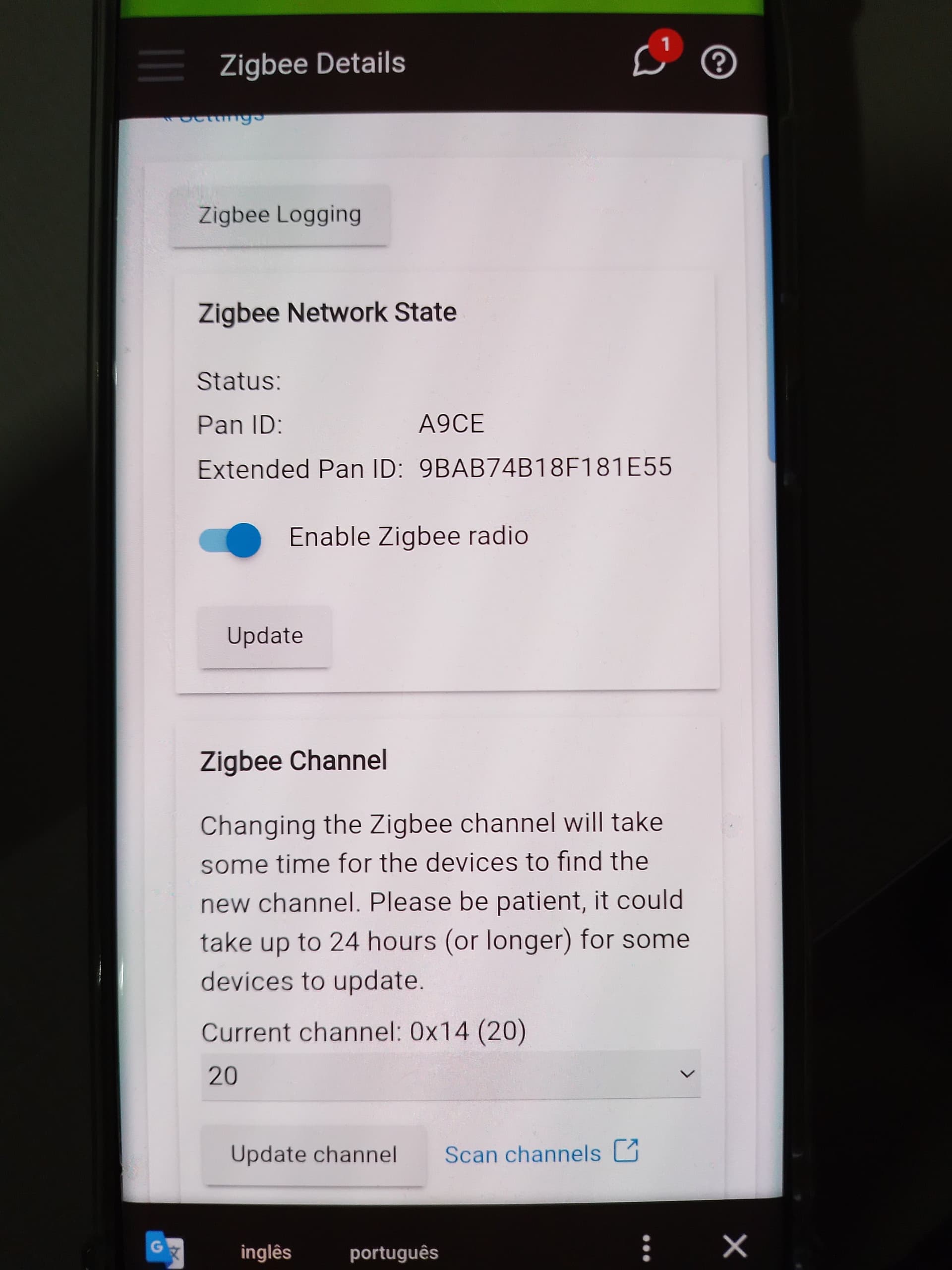

If you go to Settings -> Zigbee details, do you see the Status ONLINE and Pan ID / Extended Pan ID values populated?
Exactly, and my online status doesn't appear, it's been like that since then.
Guys, I tried to do the network reconfiguration, the hub's IP number was changed, but the ZigBee network state remains blank, without any information. I took some prints of the logs so you can see if you can give me any information. Do you think IWill I have to reset, I adapted well to hubitat, but I don't know how to solve this, I'm lost.

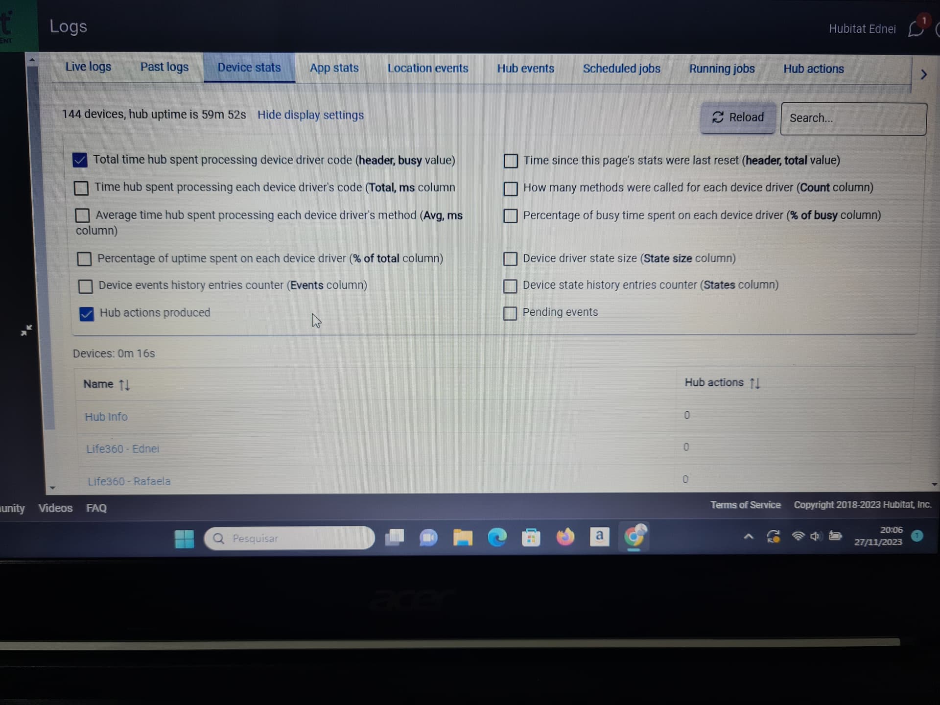

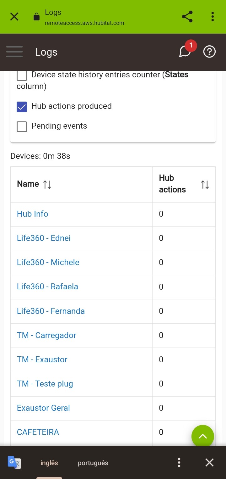

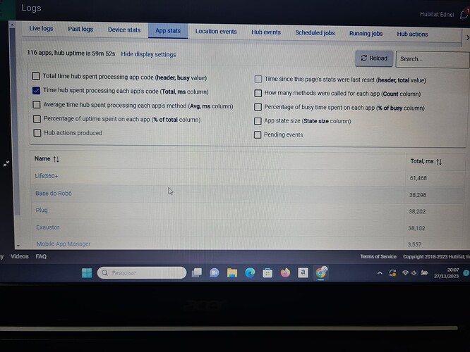

Also it would be good if you could log in on a larger screen (like a PC) to get full size screenshots of the device/app stats pages, pretty much all the info you have shown is incomplete because we cannot see everything on the small screen.

How many zigbee devices do you have? You could try a Zigbee radio reset, BUT you will need to pair all the zigbee devices again by going to each device, resetting it and getting it into pairing mode. They should attach to the same "device" in Hubitat once paired so any linked apps and automations will keep working.
The other thing you could try is to take a local backup and download a copy. Then from the diagnostic tool, do a soft reset, DO NOT restore you backup. Get back into the hub with a clean slate and see if the radio will come online. If you can get it online then try restoring the backup and see what happens.
I performed the second soft reset option, it went online, I made the backup, and it remained online, wow what a joy, I noticed that the devices came back, but for it to work I have to repair it again, even though they are installed, but if necessary I will do it with great care I like.
