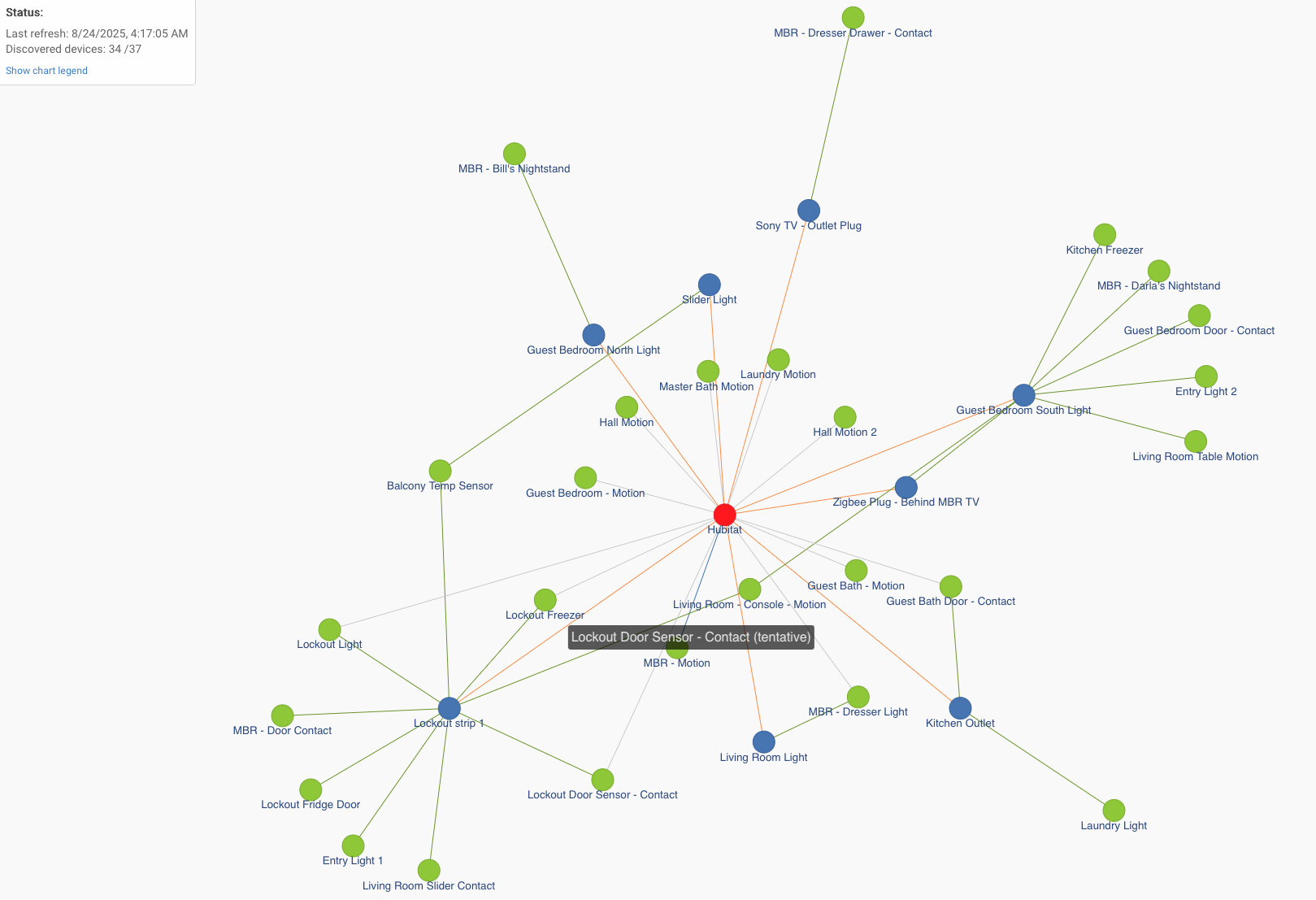

If I look at the zigbee graph the devices do show up there along with one that is 0000 and I have no idea what that is. It doesn't show up in the device listing.

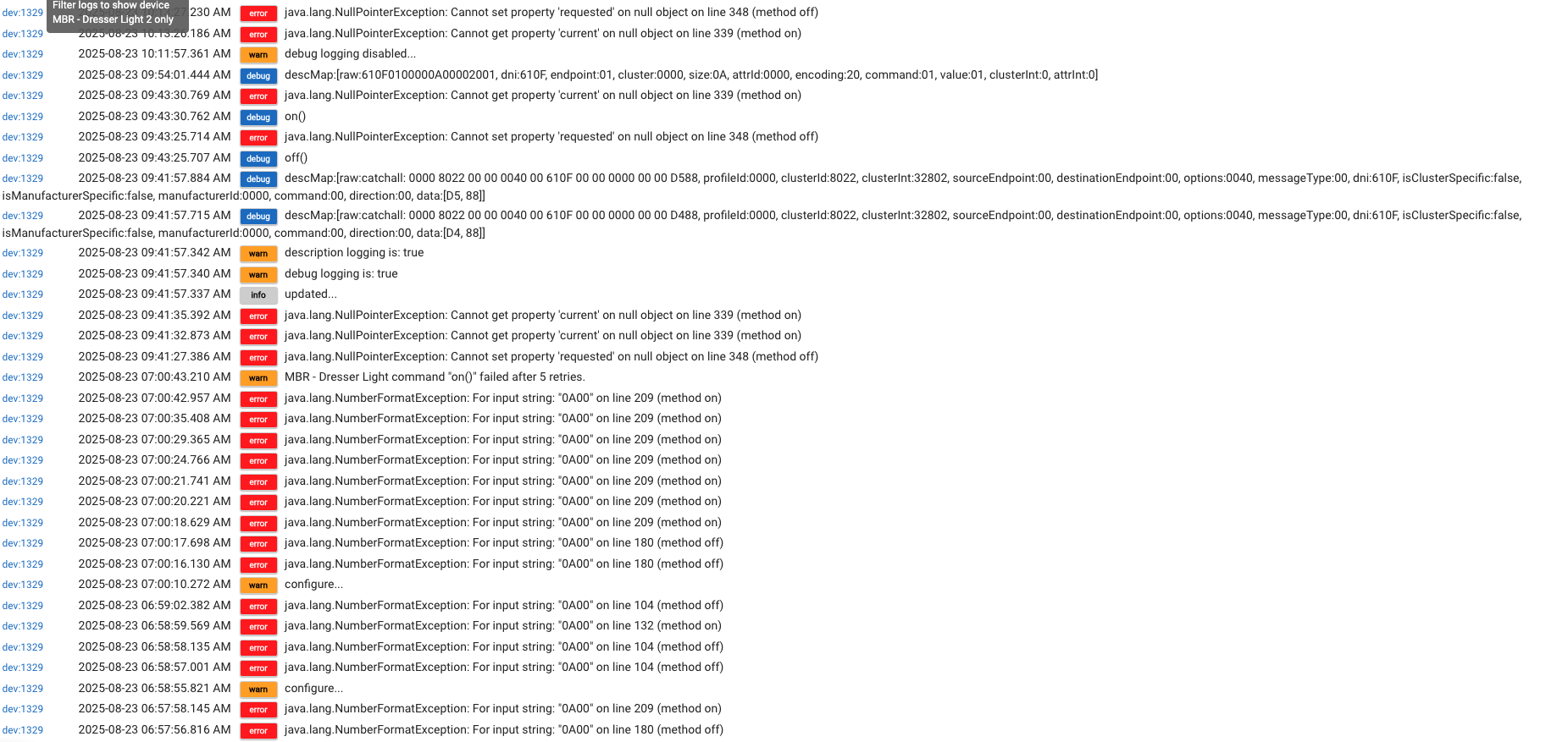

Debug logging shows some errors and I confirmed I'm using the same driver for all my Sengled bulbs and others don't do this:

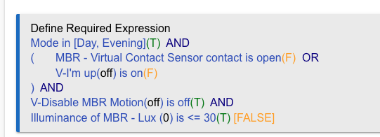

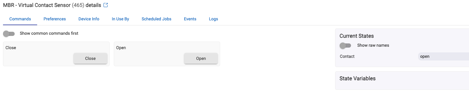

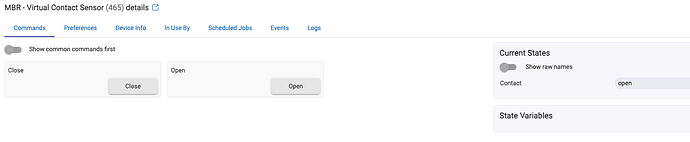

Well I may need to go to an older backup... I configured a virtual contact sensor for the one the one contact sensor that isn't responding I have it set to "open" and I replaced the "bad" device with the virtual one. A rule that checks the device state shows that it thinks it's closed yet the device shows open from the device page as well as from the dashboard. I've reloaded the app several times but I still show it as "open being false".

A shutdown and reboot fixed the issue with the virtual contact sensor. Right now I have 2 zigbee contact sensors and 1 zigbee light all failing to respond but they all show up on the zigbee graph.
Sometimes you need to toggle the “show current value “ switch in the app page to get the “real” values.
I exited and reloaded the app several times. I'll try that next time. Thanks.

Try this Zigbee Map. It helped me when I had a problem like yours.
Okay that helped. I have a Centralite Zigbee Plug that everything that wasn't responding was on. I have removed it. Some things still aren't working so maybe they need time to find new routes I guess. I'll give it some time. I have guests here or I'd reboot the hub to see if that would speed it along.
most of the connections from your routers to the hub are red, showing low signal.
I went through and disconnected most of my repeaters showing red connections
