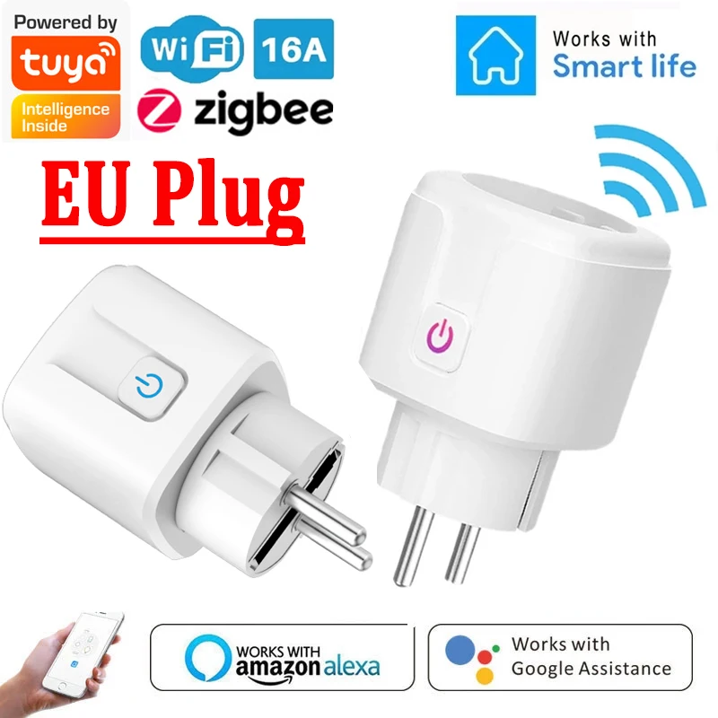

I use them with "Generic Zigbee Outlet" driver. Power on/off works fine , however I can not see any value for current or power on the device.
Is there a better driver which would work with these ?
Also, can I use these as a way of detecting electric outage if I use them on the main line without any ups ?

well, I am not sure but the listing says "with Energy Monitoring"
so I assume it should send some data about power usage.
how can I be sure ?
also any other drivers to test ?

I have the same (or similar) device, model: TS0121, * manufacturer: _TZ3000_g5xawfcq.
The power, voltage, amperage, and energy reporting have a bit strange behavior, even when paired to Tuya Zigbee hub... When my time permits I will look deeper into it.
ok , if you find something, can you post here ?
I tried at least 4 different drivers but none of them were successful at showing power.
so I gave up and started thinking it was a false listing on Aliexpress.
Are you sure that you have the same model and that it reports power (at least sometimes) ?
Yes, I will write to you here when I have it working.
The same device is reporting the measurements in other home automation platforms, so I believe it is just a matter of proper configuration by a driver here in HE.
Yes, but the problem is that Tuya often do not follow the Zigbee standards - otherwise, the standard HE built-in drivers would work out of the box with their devices.
Good news - the power, energy, voltage and amperage can be read from this outlet.
Bad news - there is no automatic reporting (based on the power/current change), so this device needs to be polled by the driver periodically.
