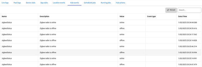

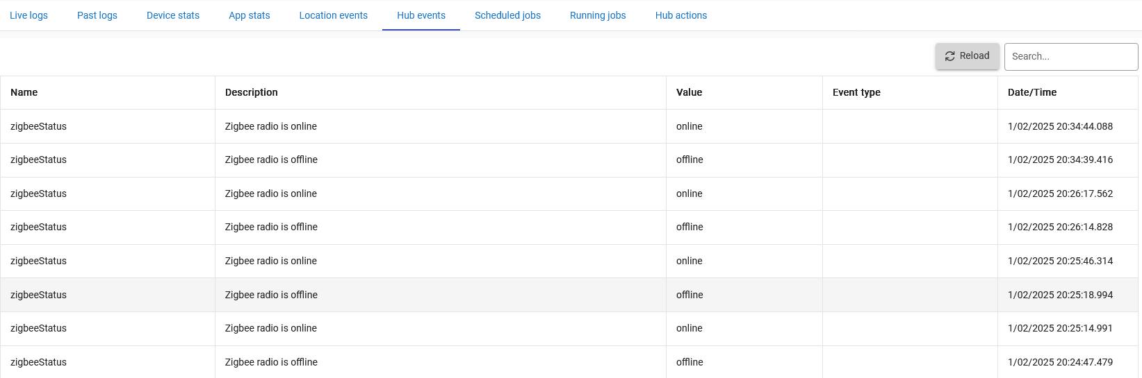

After a few days of leaving the hub off (a lovely Christmas when I still had to explain to my understanding wife that something wasn't working at home), I tried restarting the hub a couple of times. The zigbee periodically reboots after a few minutes, always shutting down for good after a few hours. After rebooting the hub, the situation repeats.
I've gradually taken down all 100 devices, always checking the logs. No change. I also turned off all applications. Finally there is no traffic on the hub at all. Zigbee keeps shutting down after a few minutes.

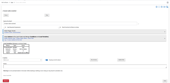

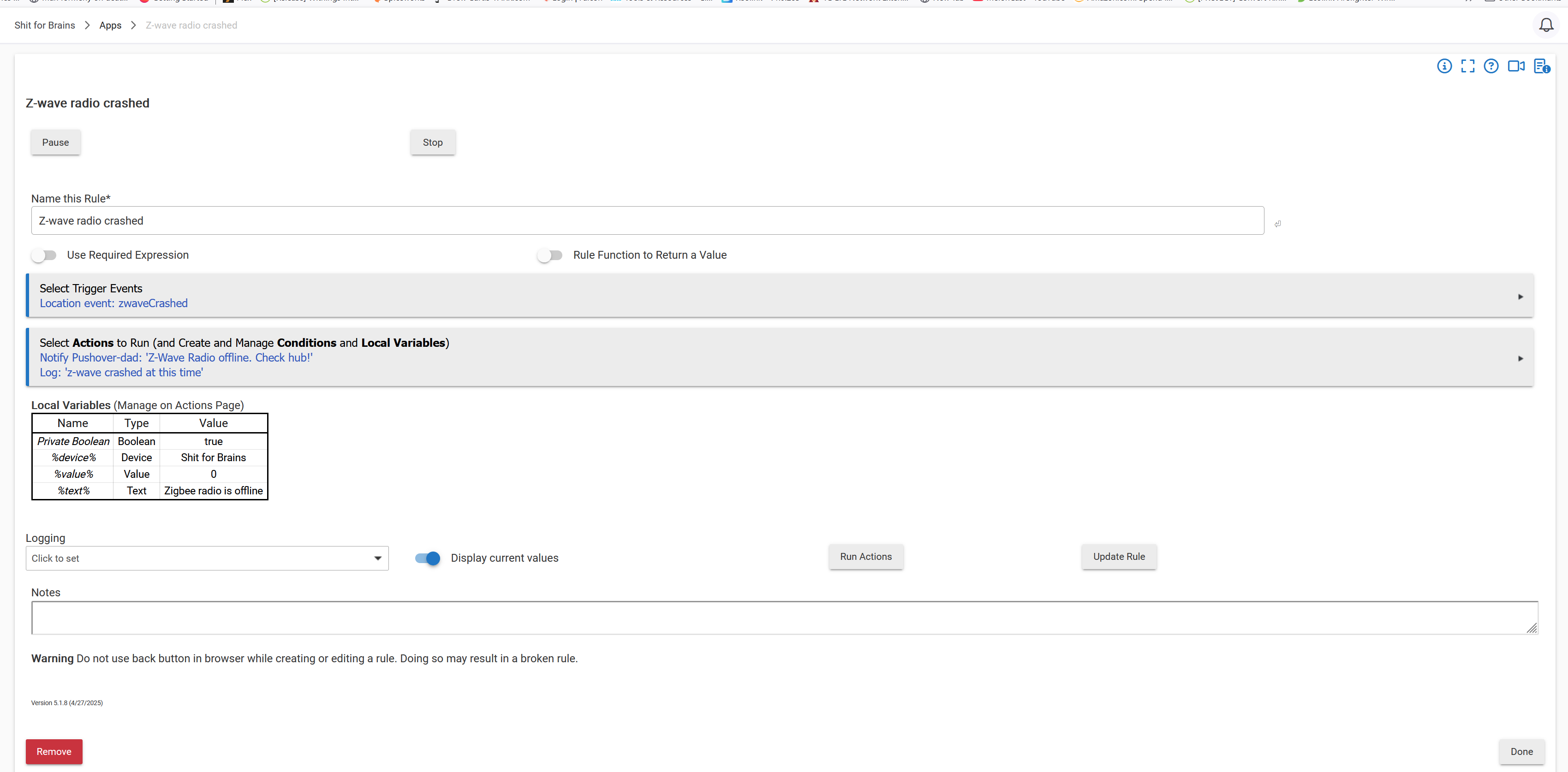

So.. Is there a way for the Hubitat to send a notification if the Zigbee or Zwave networks go down? perhaps kickoff an automation that restarts the hubitat?
I was thinking, if there is no way to have RM restart the Hubitat, it could kick off a virtual switch to an Alexa switch that forces a reboot.
Substitue zigbee for z-wave
