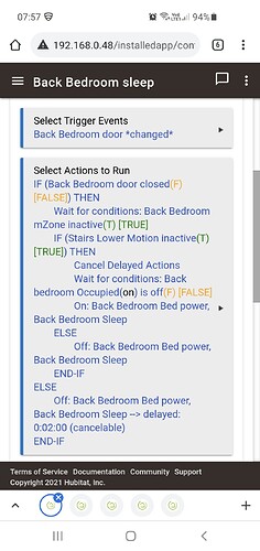

I have a similar rule, I use hue motion sensors set at 15 sec on the stairs and 10 in the bedroom (motion zone has 5sec clear). Hue sensors don't seem to have a blind time

I'm guessing inactive is controlled by the hardware not the driver as hue's seem to always report clear exactly 10 sec after motion stops
So exactly the time you stop moving plus the 10 is when it reports inactive
