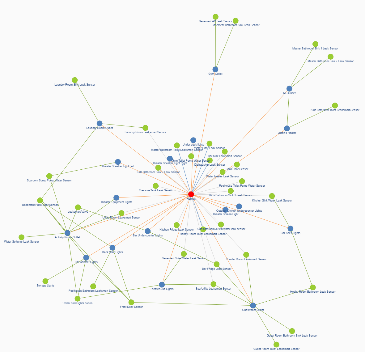

Hey Folks, so my Zigbee mesh been mostly fine and stable for the last few years, since having trouble initially, so this is more of a generic question. I just ran a mesh discovery for a while and it looks pretty messy. Multiple routes (i thought Zigbee cant do that).. how does this look and do i need to anything to optimize?
This tool draws the mesh by showing what route messages took to get to the hub. It doesn't show an instant in time, so if things change over a few minutes, it can appear there are multiple routes. But there aren't.
If you don't have any Zigbee mesh issues, don't worry about what this shows.
One thing I do see is that you have a very healthy ratio of repeaters to non-repeaters, so your mesh should be able to grow without issues (assuming they are well distributed location-wise).
Thanks for confirming and yes, all works fine (other than the leaksmarts dropping occationally) the issues i had initilly were mainly due to not having enough repeaters, but i've added more, it solved just about all issues.
