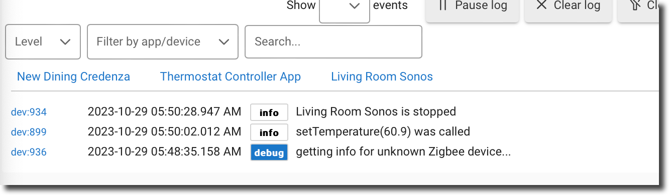

Change the driver to the HE inbuilt driver named ‘Device’. Click on the ‘Get Info’ button and copy/paste here the 4-5 lines that will appear in the live logs.

Stuck at 'getting info for unknown Zigbee device...'
Not much change
Seems like it is not communicating to the hub at the moment..
