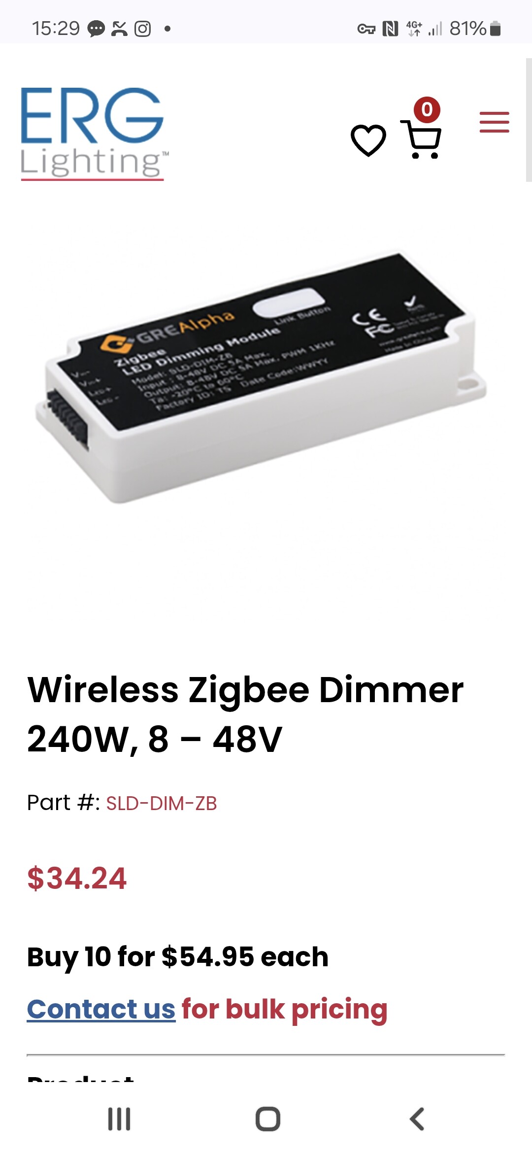

Im over in the UK and have been searching for a smart solution to dim a 20 meter, 48v led strip that pulls 240w of power.
Most smart dimmers will not dim this amount of power, but i came across a 48v zigbee dimmer from erg lighting.
Because its dimming on the led side of the driver i dont need to worry about UK power being 230v compared to the US 110v
But can anyone let me know if there is any available driver that will work with this dimmer please

Back to your original question, I think that the Zigbee dimmer you originally posted will most likely work with the Generic Zigbee Dimmer driver built-in to Hubitat, so I would just buy that. Every generic Zigbee device (plugs, relays, etc) I've bought is able to use the generic Zigbee drivers in Hubitat, if they are just basic devices, like that dimmer.
