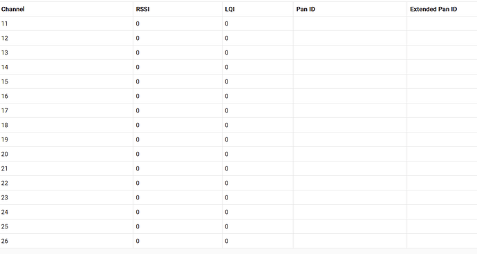

Is "Scan Channels" supposed to work? All I have seen (for MANY months) is this:

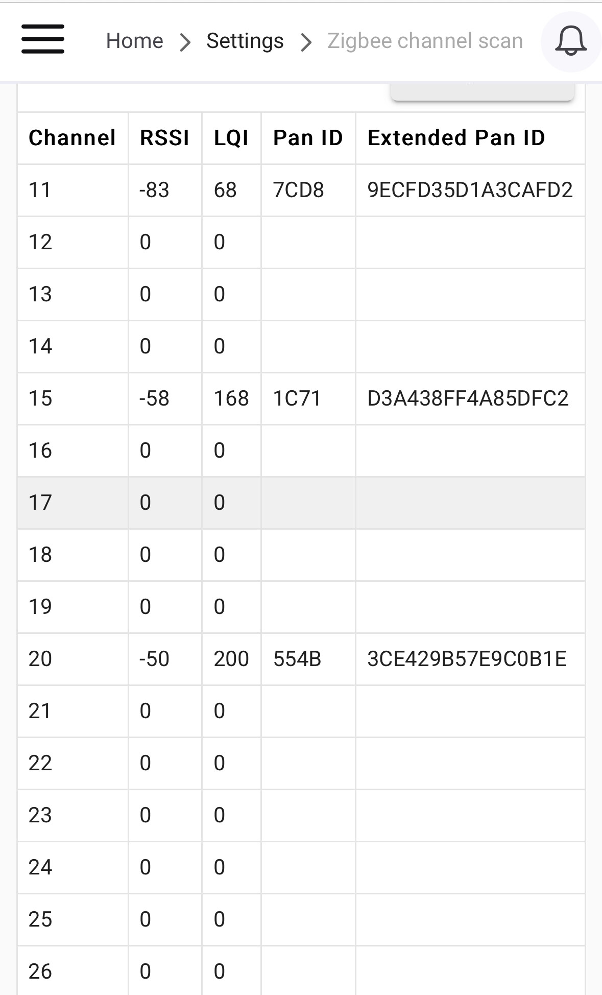

Yes, it works. Try a refresh on the page if it doesn’t populate.
11 is someone’s hue bridge. 15 & 20 are mine.
Nope, still doesn’t work, despite multiple refreshes.
thanks for the info-
my zigbee channel appears to be set the same as yours channel 20 (default ?)
upon a scan i see only one item appearing on channel 25
should i see my own system plus all zigbee devices or just the hub in the table and what might be this "unidentified" item i see on channel 25
thanks
Someone else's zigbee mesh. Hue meshes often appear on channel 11.
All the devices on your zigbee mesh use the same channel as the hub. So you'll see just the coordinator/hub in the table.
