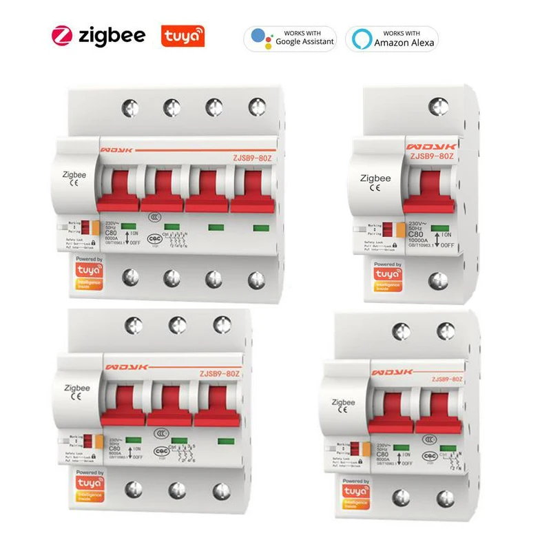

Does anyone have any experience with these?
Would be great if there was an existing driver for this or if anyone could confirm whether the generic zigbee switch could work on this.

They seem like a very bad idea for a few reasons. Here are some off the top of my head.
If you are outside of North America, some of this may not apply. Other than they are cheap breakers with no track record, no standards, and made in China. What could go wrong!

Reason why I'm considering this is that I have 2 underfloor electrical heating rings which are sitting on a 20A and 32A circuit breaker.
The in-room control is a very outdated (i.e. fugly!) single pole on/off thermostat which I would rather get rid of which has no neutral. This implies 99.9% of my smart thermostat options are out of the window right off the bat...
What I wanted to do instead is to ditch the thermostats and just connect the 2 cables that are currently hooked up to the thermostat, completing the circuit in an always on position, plaster over where the thermostats used to sit and then install these circuit breakers and dictate on/off status of the heating circuits via zigbee temp sensors in the room instead.
Happy for any other solutions you may be able to offer that aren't circuit breaker related, but I'm not seeing how else I'm going to be able to achieve what I want any other way at present unfortunately.
If they were approved and also monitored energy I would be in. But as the above posts even in the EU these would never be approved.

if you can't use that, a lower risk option than the ..ahem.. unproven chinese-manufactured zigbee breaker" (if you can safely mount it in your switchboard):
use a 'proper' Clipsal/Hager RCBO to power an Aeotec Dual Nano, and a 'proper' 2 pole contactor (e.g. Schneider 32A). the Nano switches each contactor pole on and off. that way circuit protection is done by legit devices, loads are controlled by a zwave device which only has to switch extremely low current (contactor coil), and the zwave device is also electrically isolated from loads/people by the contactor.
you would need one extra pole (spot) left in your switchboard/distribution board to achieve this.

Actually, I alread have the Hager RCBO and Contactors in my fusebox...
I thought it would just be the easiest way if I just swap out a 'dumb' breaker for a smart one in this case...

I'm intrigued by the Nano setup you described though, keen to know more! How can I hook that up to control this without it acutally being confronted by the load? Anything that gets placed in-line will need to be able to handle the same load as the actual breakers or else it would fry. So minimum 20A for the smaller of the 2 heating circuits and 32A for the larger of the 2 heating circuits we commonly use.

Yeah, built-in energy monitoring and breaker status would be cool.
But as far as the rest, I'd be shocked (pun intended) if any residential building code body has gotten beyond the long held (and deliberate) box separation between Power Protection and Control Systems. Obviously by the looks of that picture of his panel some are heading that way?
Not sure about Australia electrical code but it's a huge NO NO to have infloor electic heating with no overvoltage/GFCI protection thermostat.
You can get a zigbee infloor thermostat here.
In general "breakers" are not to be used as ON/OFF switches (although I understand many commercial building control the lighting with breakers).
I think the advertised ON/OFF cycles (10,000) is rather low for automated switch.
Visually they look similar to a DIN type of mounting (FWIW).
What would happen if you heaters were on 100% of the time due to some failure?
although its not a bad thing you pointed it out, we're way ahead of the americas for a change wrt this - in australia every circuit in the house needs what you guys call GFCI protection. so a thermostat with GFCI is redundant here.
i did cover this off in my earlier post, over here we call a GFCI an RCBO
In the US, as of 2008, I think the NEC requires combination arc/ground fault breakers (CAFCI breakers) for circuits that supply power to all living areas. Obviously, this doesn't apply to much older homes like mine.
