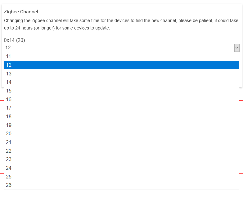

When I go to HE and want to use Channel 8, I can't... That channel isn't offered.
How do I use Channel 8? (I am aware the recommended channel is 20 but wanting to try others for test purposes) Am I misunderstanding how this works or is there a mapping here?

So. to use channel 12 from XTCU equates to what HE channel?
Just add 11 to your XCTU channel to get the real zigbee channel number.
0 = 11
1 = 12
12 = 23
