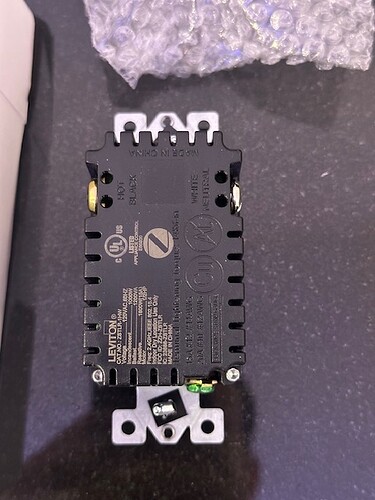

I discovered the Leviton ZSTLR-1HW and bought two of them. I asked like five suppliers for pricing and availability, but only GoKnight came through and shipped it. The ZSTLR-1HW works.
Advantages:
  • Currently manufactured and supported by a major electrical supplier (Leviton)
  • Zigbee 3.0
  • Actually marketed as Zigbee 3.0, not marketed with some other proprietary brand name that may or may not interoperate with various Zigbee hubs
  • Has a button on the face to control it
  • Blue LED light is very small and not annoying
  • Looks like a pretty generic but functional outlet; no weird or confusing markings
  • Silent: no perceived humming or whining from the electronics
Disadvantages:
  • No energy monitoring
  • Only comes in white
  • Expensive (USD$62) for what you get
  • Not "widely" available, requires working with your Leviton supplier
I have not installed it in a junction box yet, but I also want to point out that it is pretty thick. I estimate that it is the same thickness as Leviton's USB-C receptacles.

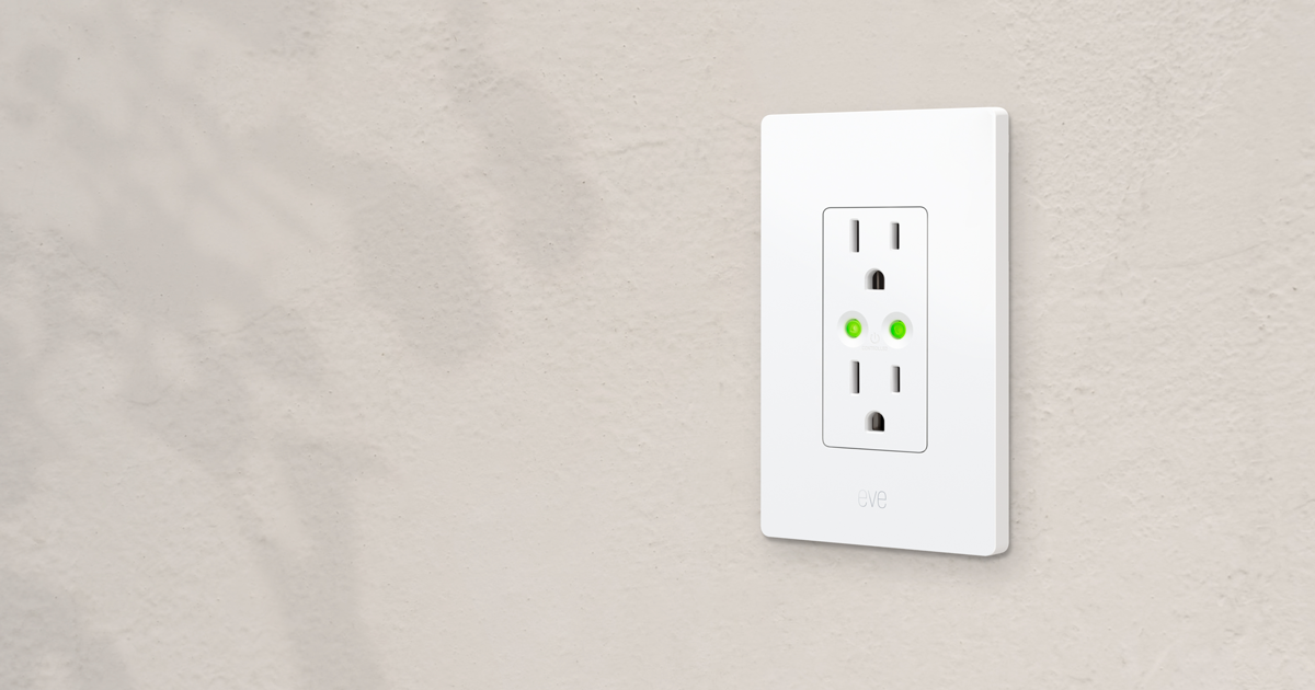

Interesting wasn’t aware of NEC requirement about one outlet being always hot. Could have sworn I have seen a zigbee or Zwave receptacle where both were controlled at some point since I got into HA 10 years ago. Know Kasa has a WiFi outlet where both are switched.
Eve has a dual outlet but it’s thread.
