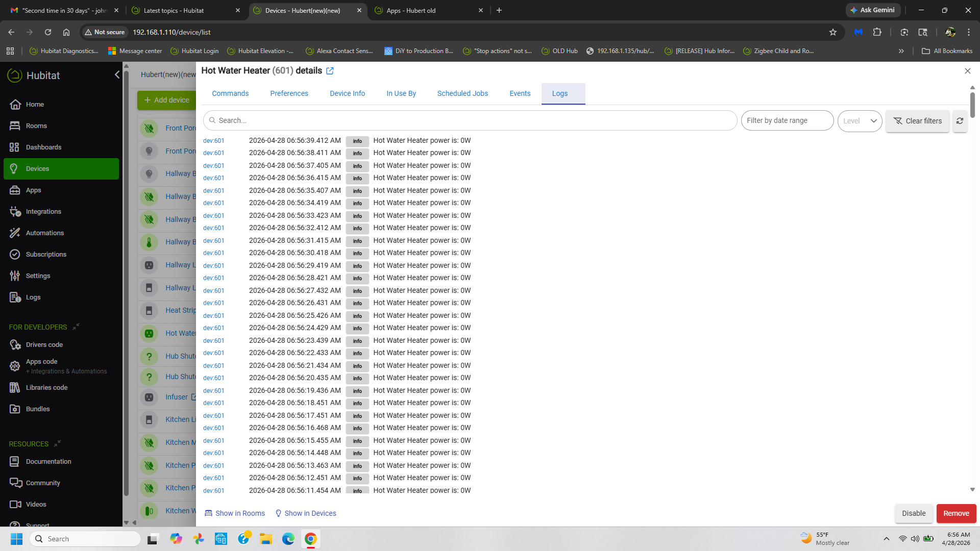

Zen78 Logs Spammed C8 Pro

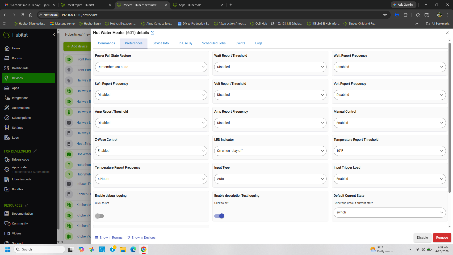

Just noticed this. Watts is disabled in preferances. Not sure what has caused this to happen but before it started I have updated to 2.5.0.123 and had to abort a firmware update with the device firmware updater as this was one of the devices that would never start a file transfer. I have killed power to the unit and also tried changing the preferances.
I got that when I changed the frequency of reporting parameters to zero, as in disable. But...it doesn't, lol.
Oh, and the parameters go out to a month...I think the system driver goes out to 24 hours.
