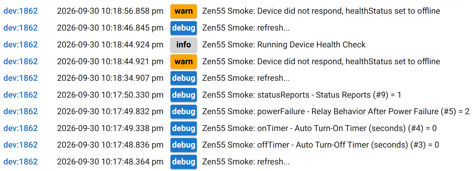

Zen55 offline since 2.5.2
This is no longer a beta issue. Quickly goes and stays offline after Refresh. Refresh takes it offline. Was stable for over a year until a week or two ago. @bcopeland @jtp10181
https://community.hubitat.com/t/2-5-2-124-zooz-zen55-goes-offline-during-refresh/166464
