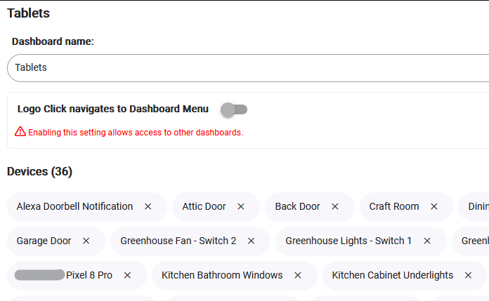

Apologies for the delayed response. The device functions in rules and if I issue a voice command to Alexa (however in this case while it does turn the device on, Alexa says the device did not respond). The device is also associated with the dashboard (shown below):
Device in question is called Kitchen Cabinet Underlights
