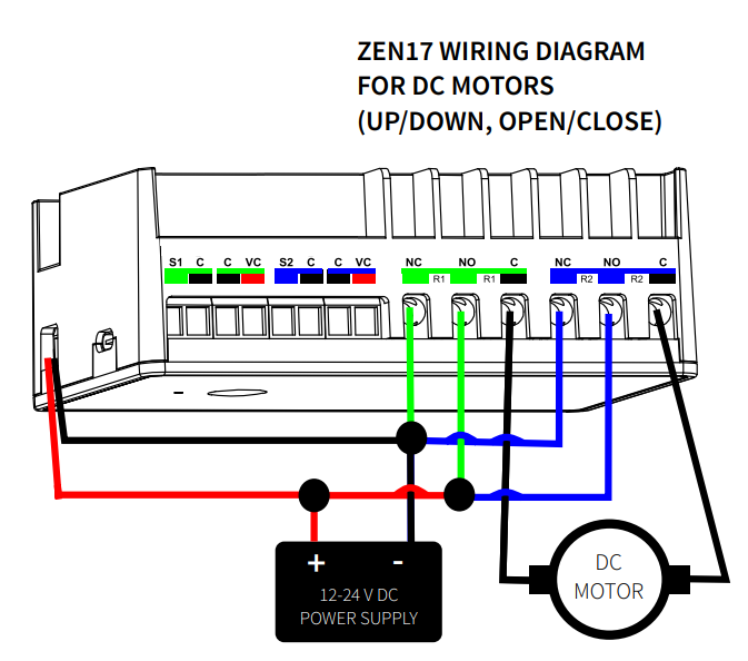

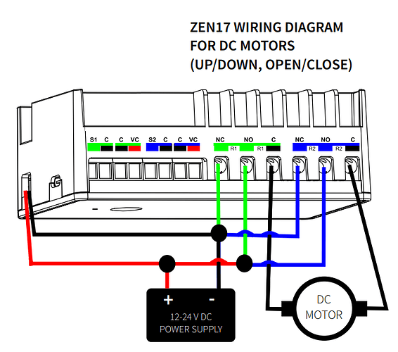

anyone used the 2 dry contact relay ZEN17 to control blinds? where zen17 controls the up and down using both relay. like this:
probably not much of a big deal to create a variable to keep track of where the shades are at. like if it's a 16 seconds travel for the shade to go from all up to all down, and use a zen32 button keypad to have a UP and DOWN button I can hold. and some pre-set level like 25% or 50%. so if blinds are all up, I hold DOWN for 10 seconds, so variable is at 10. then press 50%, then they need to go up for 2 seconds to be at 8 (which is 50% of 16 seconds)
anyone done it? share some tips? am I over thinking it?
