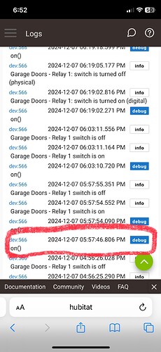

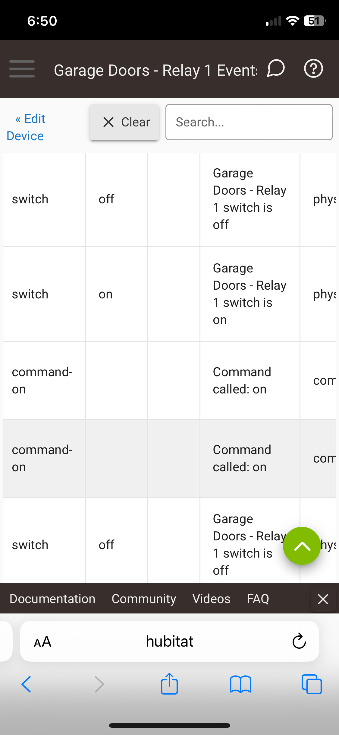

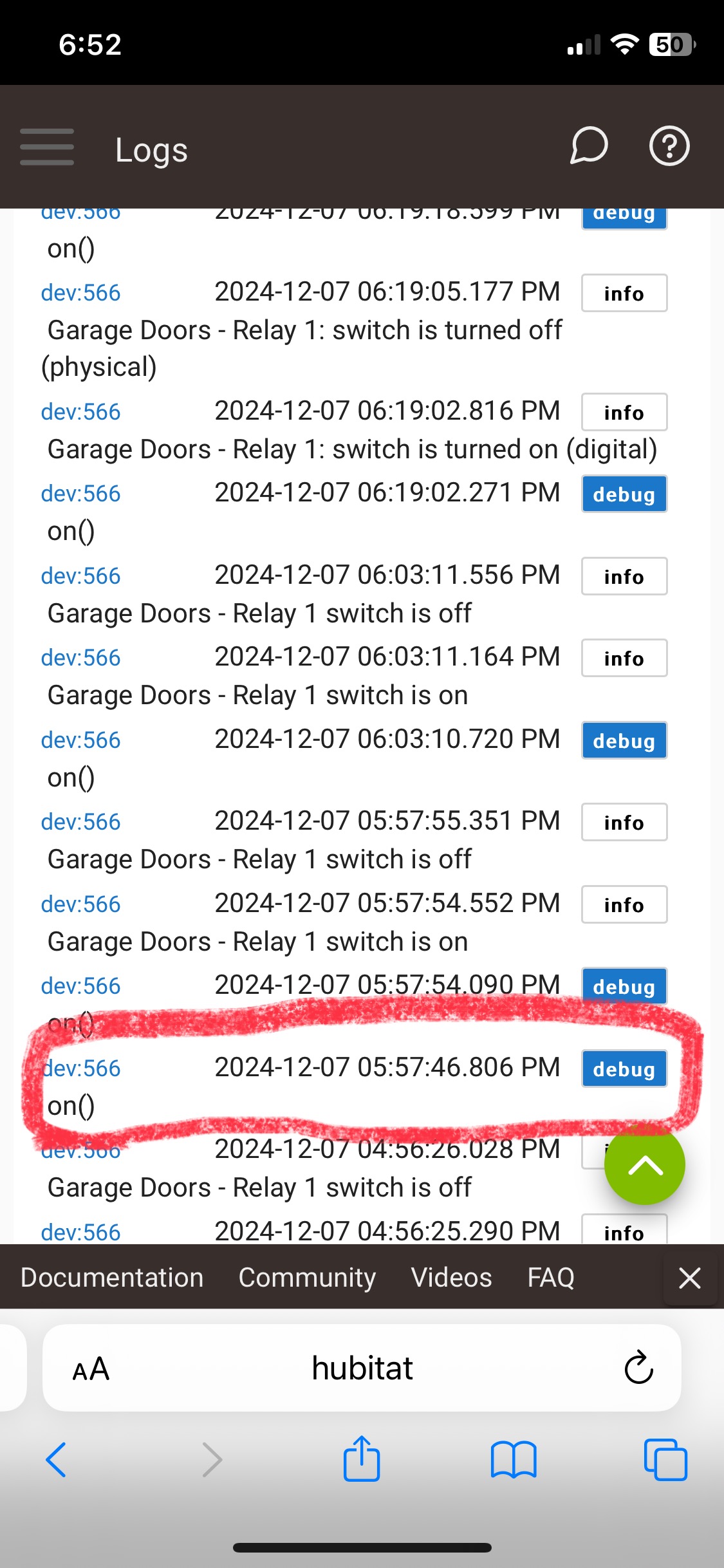

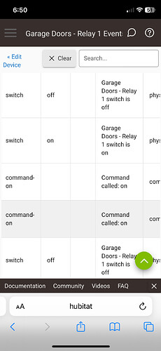

The problem I’m having is that after a period of non-use, the relay fails to activate the first time. This is happening on both relays. After the first time, it works reliably again. The relay child device logs shows the On command called, but that first time, it does not show the relay turn on. The second on command works fine and the logs show the relay turn on.
Any ideas?
Log/event screenshots - the failed on command is “highlighted”:

Ha! I was just about to say that. I did adjust the auto off parameter to 3 seconds about 30 minutes ago. I noticed in the logs that at 1 second, it was actually opening the relay around 0.5 seconds after closing it. I also noticed that in some cases it took longer just to activate the relay. We’ll see if that helps. Fingers crossed.
